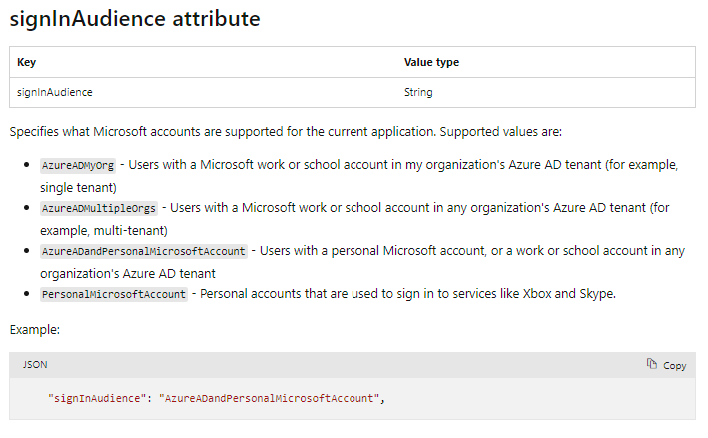

    Seems like currently your application is registered as a single tenant app hence it won't allow users from any other directory.
    Multi-tenant application will allow the accounts in any organizational directory to login.
    If you want accounts in any organizational directory and personal Microsoft accounts to login, you should use Azure AD v2.0 endpoint and change your account type.
    Or you may also change the Supported account types to Accounts in any organizational directory (Any Azure AD directory - Multitenant)
