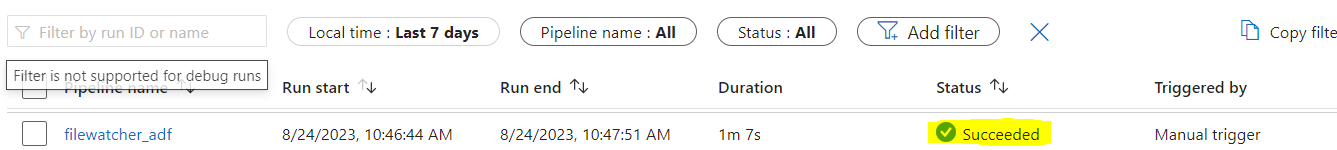

I have a requirement where I need to continuously check for a file and restart other pipelines only if that file is deleted.
I have a working powershell script which is working fine in windows powershell ISE.

I have kept it at blob and running it by powershell.exe script.ps1
But it is not waiting for the file to be deleted, it just completes without throwing any error.
