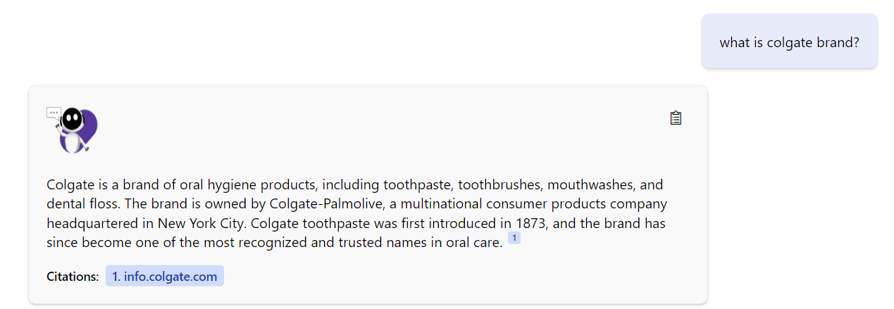

Using the python's api for ChatCompletions I tried running the use your own data functionality from the official repo: https://github.com/microsoft/sample-app-aoai-chatGPT .
However, the responses are not limited to the documents I have uploaded.
I could not find any parameter similar to the checkbox in the playground for "Limit responses to your own data" and was unable to achieve good results when tried prompt engineering for the same.
Is there a parameter for api or code snippet that I might have missed in the official documentation?

    Alright so from what I have searched, there isn't any native configuration that can solve this issue, regardless of whether you are using azure openai or openai itself.
    The best possible way that I found in order to limit the response is to either use a binary classifier (detect if a prompt is on-topic or off-topic) or to use a a similarity detector between whatever you are getting from the search results and the answer. I used a similarity detector that returns a score between 0 and 1 based on the similarity between the search results and the prompt, set up a threshold and if the search results fit the user prompt, the score will be high and it'll be on-topic.
    I really hope that they add some sort of configuration setup but I think it'll be challenging as it is very difficult to limit the model's response, and even in the playground the sometimes hallucinates.
