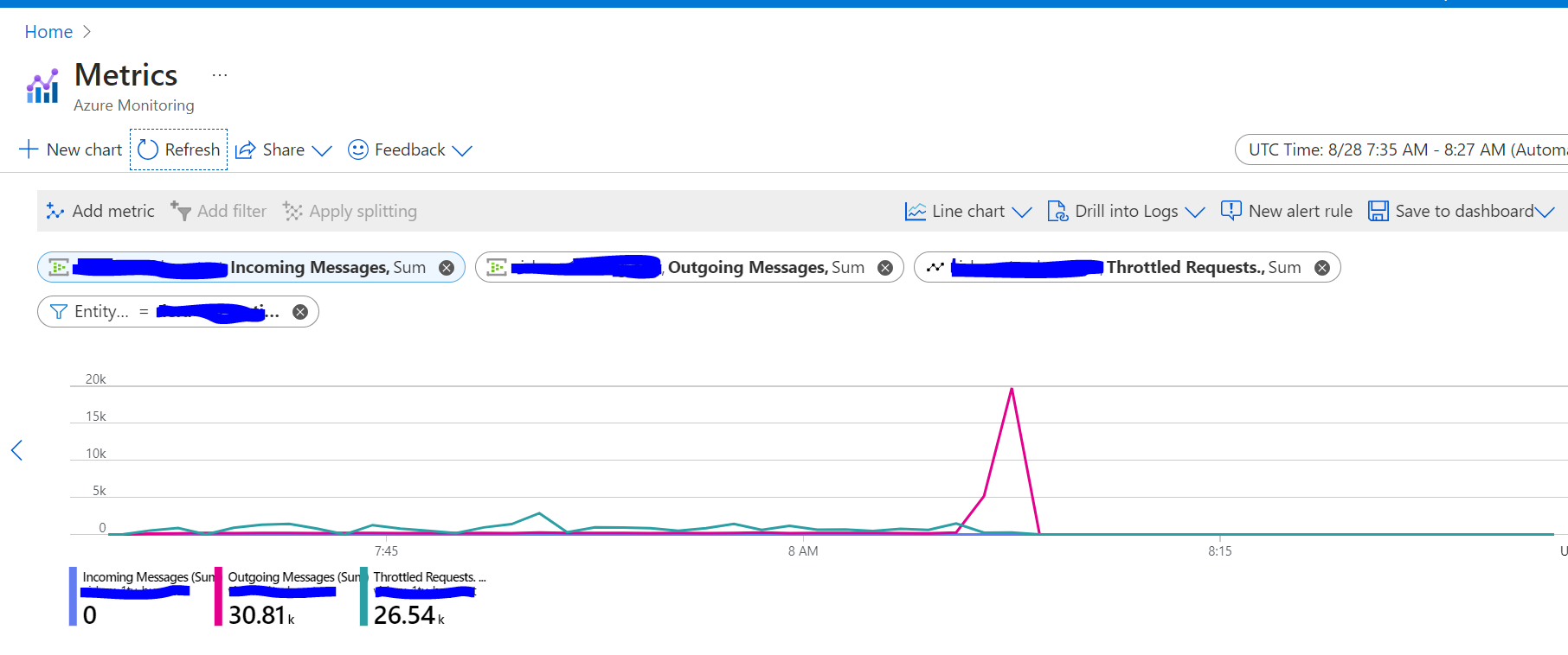

Single consumer is consuming the message from the single topic partition. The consuming topic partition has 8578 messages The observation from Azure Eventhub Metrics, Outgoing message is high and seeing the Throttling Request.
This test is performed in Azure Eventhub with Standard Tier with 1 Throughput Unit.
Expected Result
Should see only the 8578 message in Outgoing message metrics and no Throttling Request should see.

Consumer Topic Metrics
Note: The incoming messages is there is different time frame. Messages are accumulated once performing the test with different ConsumerGroup for each run for test

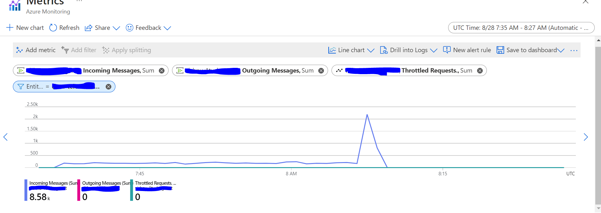

Producer Topic Metrics

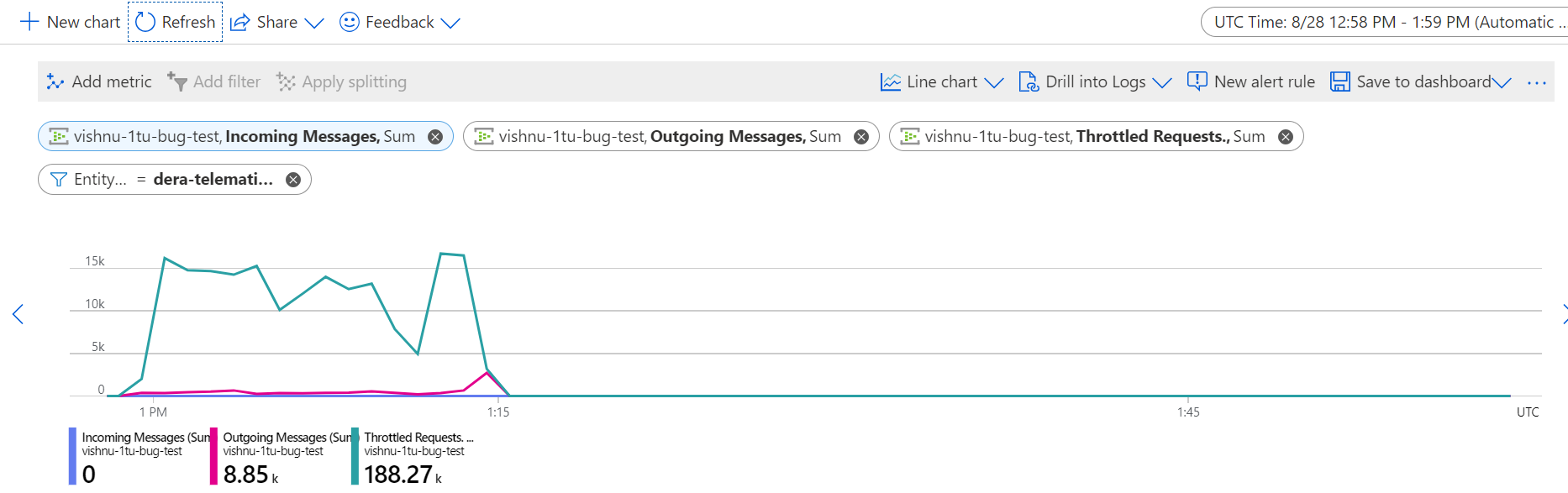

But if i update AutoCommit is turned on, I see the below metrics
Consumer Metrics
Producer Metrics

    Apologies for the delayed response @K S Devadoss, Vishnu Kumar . I reached out to the product team and was informed that throttling isn't the main issue here. Throttling is expected when the incoming or outgoing message volume reaches the TU limits. In your case, it's 2MB/sec as the outgoing limit for 1 TU.
    They also agree that the outgoing message count does appear off and would like to look into the service logs. We can address this in the support case you opened.
