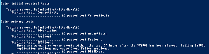

    Please run;
    Dcdiag /v /c /d /e /s:%computername% >C:\dcdiag.log (run on PDC emulator)
    repadmin /showrepl >C:\repl.txt (run on any domain controller)
    ipconfig /all > C:\%computername%.txt (run on EVERY domain controller)
    Also check the domain controller System and Replication (DFS or FRS) event logs for errors since last boot. Post the Event Source and Event IDs of any found. (no evtx files)

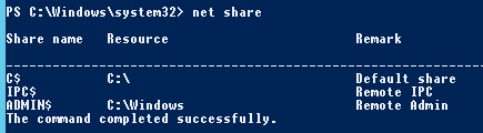

    4.Check can you see netlogon and sysvol folder by running net share on new DC.
    5.can you access netlogon and sysvol folder on new DC.

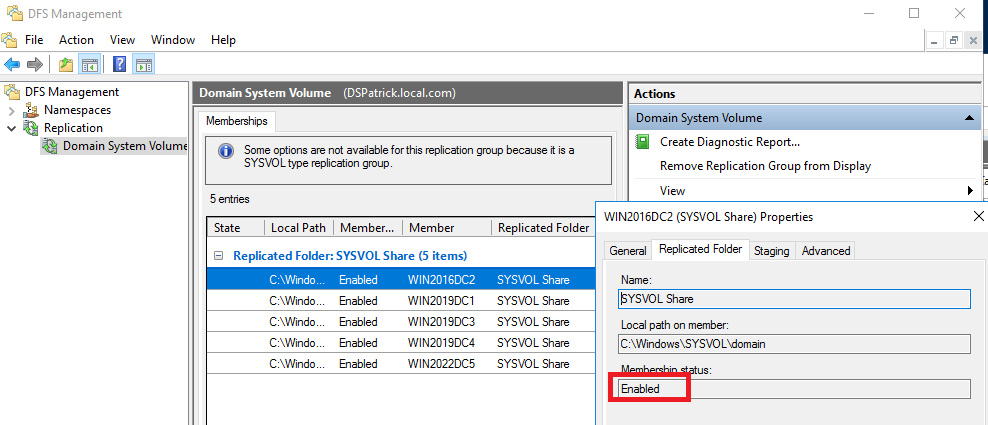

    4.Check if SYSVOL replication works fine if you have more than one DC.

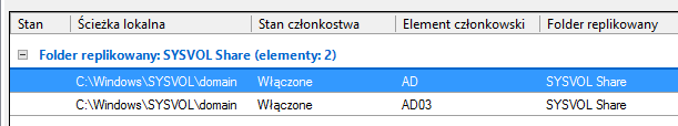

    Hopefully the 2012 is not yet demoted? You can try a non-authoritative sync
    https://learn.microsoft.com/en-US/troubleshoot/windows-server/group-policy/force-authoritative-non-authoritative-synchronization#how-to-perform-a-non-authoritative-synchronization-of-dfsr-replicated-sysvol-replication-like-d2-for-frs
