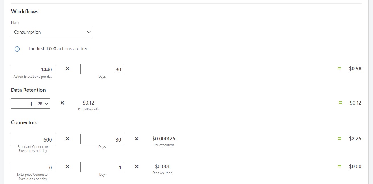

  1. Am I correct to assume that this logic app runs 6 standard connectors? Assuming that it will be executed 3,000 times (my business case is 3,000 files to be processed per month) then the total Standard Connector executions per month is 3,000 x 6 = 18,000?
  2. If polling is 1 minute, and that there are 1440 minutes per day am I correct to compute that there are 1440 action executions per day?
  3. Is the pricing calculator I did below correct?
  4. What is the data retention for?
Screenshot 2023-08-25 004721

    As you are using the Consumption tier so both builtin and Azure action/trigger will be charged per call.
    A total of 6 actions (both Azure and built in action) are there in your workflow so your above assumption is correct for the action cost in the ideal scenario where there are no failures, issue exception.
    Yes, it is correct for trigger. Per days (60 min * 24 hr ) --> or 1440 API calls
    Yes, it is correct as per your assumption and data retention.
    Azure Logic Apps uses a fixed pricing model for data retention and storage consumption. The data retention and storage consumption costs accrue using a fixed pricing model. Inputs and outputs from run history are kept in behind-the-scenes storage, which differs from storage resources that you independently create, manage, and access from your logic app. For more details you can refer to this section here.
