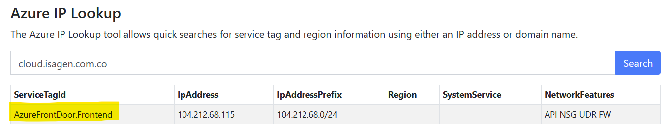

I doubt you are using an Azure Application gateway to begin with
- Are you sure this is not a Front Door?
- If I try to check your Domain "cloud.isagen.com.co" in Azure IP Lookup , I see
With that said,
- This still does not look like an issue with AFD (or the proxy whichever you are using), rather your application.

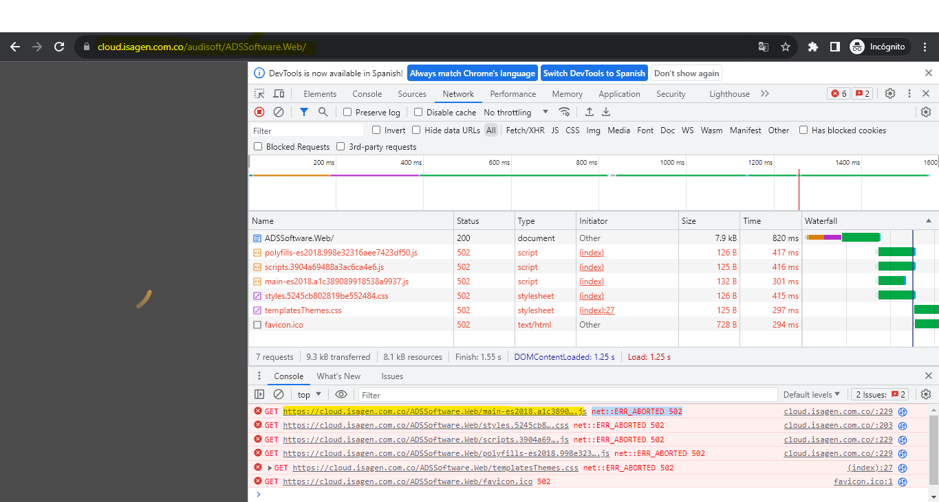

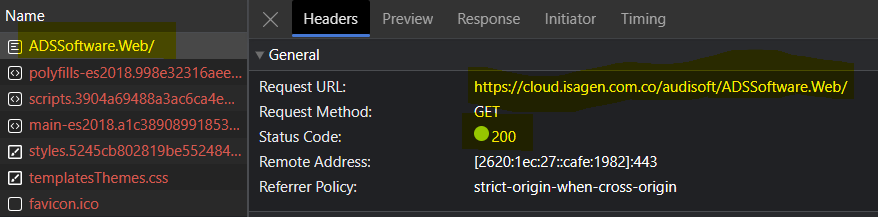

- When I access "https://cloud.isagen.com.co/audisoft/ADSSoftware.Web/" , it gives me a HTTP 200 Success

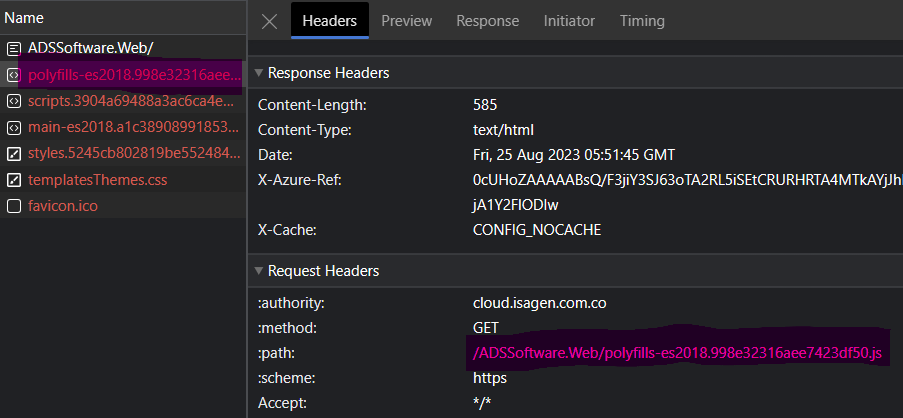

- All the subsequent requests lack the "audisoft/" in their request path
- You must note that AFD is not removing this, rather, the path requested by the application itself did not contain "audisoft/"
- This should be fixed in the application itself by leveraging "absolute URL"
- Every request must include the entire absolute path

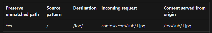

- There is a way to do URL rewrite, However, this needs to be fine tuned to your requirement and make sure this does not affect other sites behind your AFD
- You must leverage AFD Rules Engine
- Your requirement comes under the section : Preserve unmatched path
- Your environment will become,
Yes / /audisoft/ https://cloud.isagen.com.co/ADSSoftware.Web/ /audisoft/ADSSoftware.Web/
