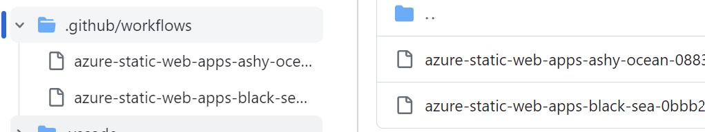

i have two static web apps and my github is building two of them every time I modify code in github as seen below:
Screenshot 2023-08-25 112058
How Do i safely remove one of them? I want to delete the ashy ocean?
I intend to just delete the workflow in github and the static web app in Azure but I believe there may be other areas I should so to delete the web app safely

    To safely remove one of the static web apps (in this case, "ashy ocean") and associated resources, you can follow these steps:
    1. Delete Workflow in GitHub: In your GitHub repository, if you have a workflow defined for the "ashy ocean" static web app, you should delete that workflow file. Basically a yaml file of ashy ocean under workflows
