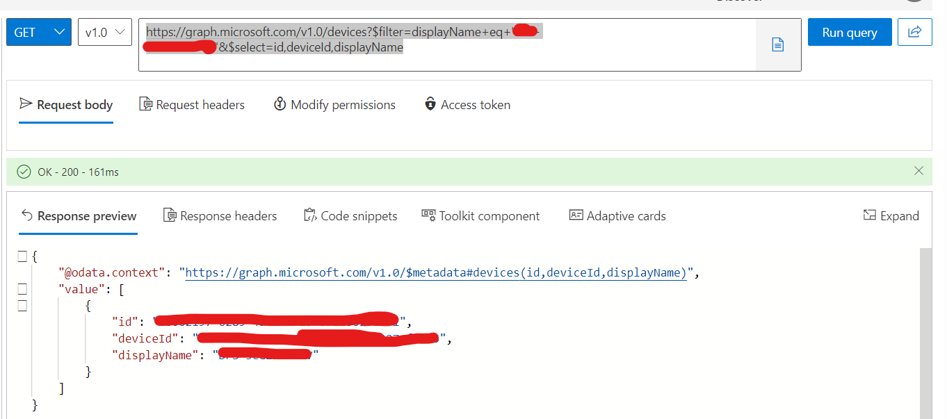

I would like to have an API where I put in the Device Name and fetch the Object ID and AAD ID of the device.
As per article: https://learn.microsoft.com/en-us/graph/api/device-get?view=graph-rest-1.0&tabs=http, the query is being run using object ID.
I tried to use API: https://graph.microsoft.com/v1.0/devices/?$filter(displayName eq 'DESKTOP-RRNFP6H')&$select=id,deviceId,displayName however it returned me all the device including the specified device.User's image
Request some help on this please.

  1. Deepanshu katara 17,960 Reputation points MVP Moderator
    2023-08-25T05:35:50.01+00:00
    Hope you are having a great day!
    The $filter parameter might not be supported for the displayName field in the Microsoft Graph API, which could be why you're getting all devices instead of just the specified one. In this case, you might need to retrieve all devices and then filter the results on your end based on the displayName you're looking for. You can use device ID parameter.
    So , The following request retrieves the id and extensionAttributes property of a device.
    Example--> https://graph.microsoft.com/beta/devices/6a59ea83-02bd-468f-a40b-f2c3d1821983?$select=id,extensionAttributes
    Moreover, if you need to do using deviceName/displayName , you can use below script to achieve this .
    $deviceName = "DESKTOP-RRNFP6H"
    $uri = "https://graph.microsoft.com/v1.0/devices?$select=id,deviceID,displayName"
    $accessToken = "YOUR_ACCESS_TOKEN_HERE"  # Replace with your actual access token
    $headers = @{
        "Authorization" = "Bearer $accessToken"
    $response = Invoke-Rest Method -Uri $uri -Headers $headers -Method Get
    if ($response.StatusCode -eq 200) {
        $devices = $response.value
        for each ($device in $devices) {
            if ($device.displayName -eq $deviceName) {
                $deviceId = $device.id
                $aadId = $device.deviceID
                Write-Host "Device Name: $deviceName"
                Write-Host "Object ID: $deviceId"
                Write-Host "AAD ID: $aadId"
                break
    } else {
        Write-Host "Error: $($response.StatusCode) - $($response.Content)"
