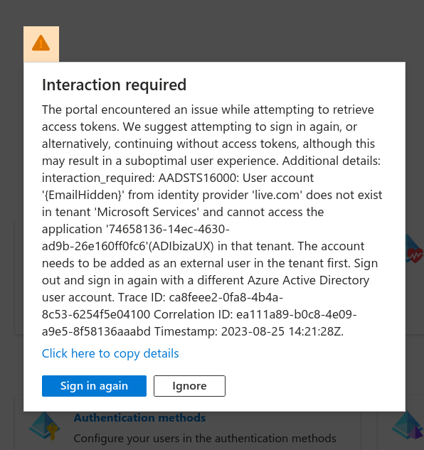

My Azure portal appears completely broken. Regardless of which page we attempt to open, we are constantly shown an error as follows:
The text is:
Interaction required The portal encountered an issue while attempting to retrieve access tokens. We suggest attempting to sign in again, or alternatively, continuing without access tokens, although this may result in a suboptimal user experience. Additional details: interaction_required: AADSTS16000: User account '{EmailHidden}' from identity provider 'live.com' does not exist in tenant 'Microsoft Services' and cannot access the application '74658136-14ec-4630-ad9b-26e160ff0fc6'(ADIbizaUX) in that tenant. The account needs to be added as an external user in the tenant first. Sign out and sign in again with a different Azure Active Directory user account. Trace ID: bfe29182-b2a9-4358-8b07-b5829ee52100 Correlation ID: af375ba9-259c-41a6-a722-a76f669e9934 Timestamp: 2023-08-25 14:13:59Z.
The details are:
  "sessionId": "18b94d44521446f4ac2c9e78abcd2713",
  "errors": [
      "errorMessage": "interaction_required: AADSTS16000: User account '{EmailHidden}' from identity provider 'live.com' does not exist in tenant 'Microsoft Services' and cannot access the application '74658136-14ec-4630-ad9b-26e160ff0fc6'(ADIbizaUX) in that tenant. The account needs to be added as an external user in the tenant first. Sign out and sign in again with a different Azure Active Directory user account.
Timestamp: 2023-08-25 14:13:59Z",
      "clientId": "74658136-14ec-4630-ad9b-26e160ff0fc6",
      "scopes": [
        "a57aca87-cbc0-4f3c-8b9e-dc095fdc8978/.default"

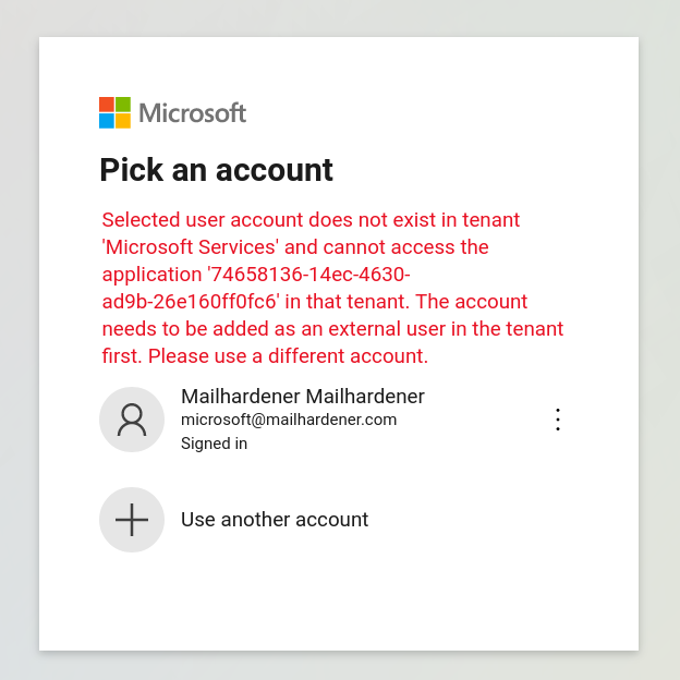

Clicking 'ignore' will close the message, only to appear again one second later. This makes the Azure portal completely unusable.
This is our main (and only) administrative account for Azure. So there appears no way to add ourselves as a tenant, if that is even possible.
What we tried so far:
  • log out and back in again
  • private browsing window
  • different browser, and OS

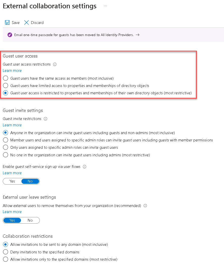

    • See if you are logging onto correct directory on your tenant:
    • External collaboration settings:
    1. Sign in to the Azure portal with Global Administrator permissions.
    2. Browse to Azure Active Directory > User settings.
    3. Under External users, select Manage external collaboration settings.
    4. On the External collaboration settings page, select Guest user access is restricted to properties and memberships of their own directory objects option.
    external-collaboration-settings

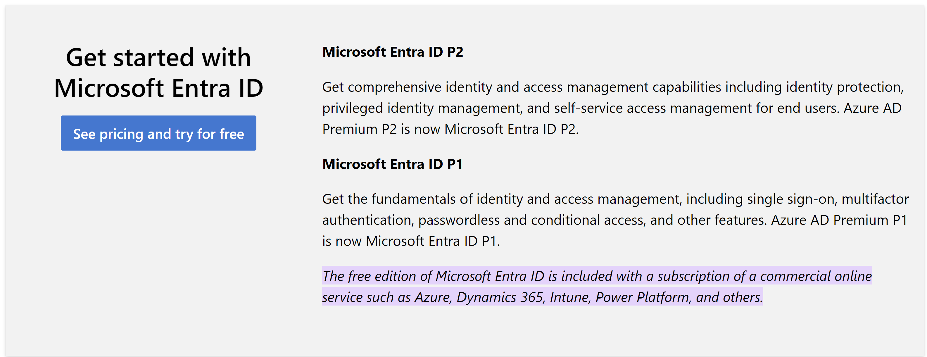

    Seems like you were using a free version of Azure AD/Entra ID. Since Azure AD is now Microsoft Entra ID,
    The free edition of Microsoft Entra ID is included with a subscription of a commercial online service such as Azure, Dynamics 365, Intune, Power Platform, and others.
    So either you may get one of the above mentioned subscription or you needed P1 or P2 subscription: https://www.microsoft.com/en-us/security/business/identity-access/microsoft-entra-id#:~:text=The%20free%20edition%20of%20Microsoft,%2C%20Power%20Platform%2C%20and%20others.
