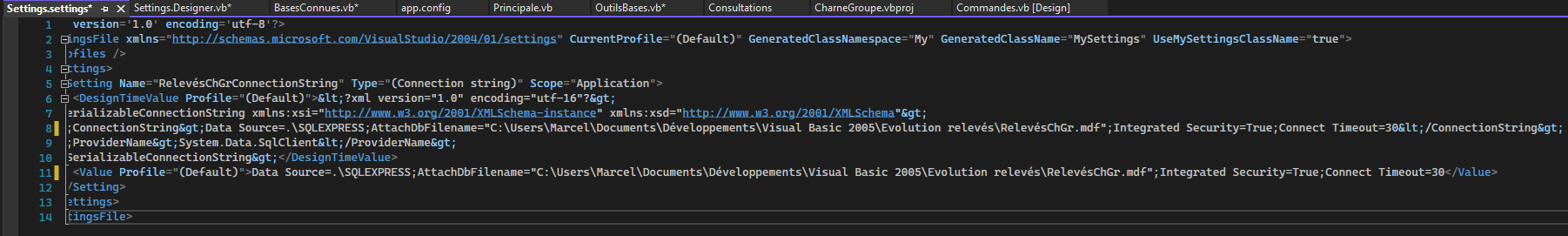

    3- The concerned application was developped many years ago by two men in order to constitute a genealogic data base of acts for their area (now more than 500K acts are registered). We were not developpers but genealogists.
    The application resisted unchanged jumping from Widows 8 to Windows 10. And the last jump to Windows 11 failed.
    This history explains archaic features of the application; I cannot modify my myself these features; I have to continue.
    Have you simple solutions?
    The instance runs on my PC, I am the only user (my friend is no more there)
