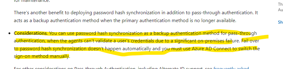

    You cant use Password Hash Sync and Pas through Auth at the same time. You would have to disable password pass through and switch to PHS auth via AADConnect
    https://learn.microsoft.com/en-us/azure/active-directory/hybrid/connect/choose-ad-authn
