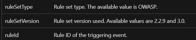

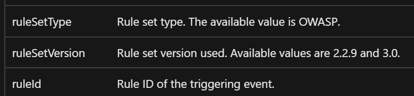

    • Do you check which Managed Rule is getting hit?
    • If WAF logs are not capturing, it means the 403 is coming from the App service itself, and should be visible in Access Logs.
    You confirmed that setting the WAF in Prevention Mode resolved the issue
    I suggested, this will make your Application Gateway vulnerable to attacks as disabling the WAF entirely (i.e, moving to prevention mode) will disable all the Core Rules which opens other threats.
    Instead, you should only disable the rule in the CRS Rules Set that causes 403 and not the entire WAF
    You can do this by following : Customize Web Application Firewall rules
    To find out which Rule is being triggered, you must use the WAF Logs
