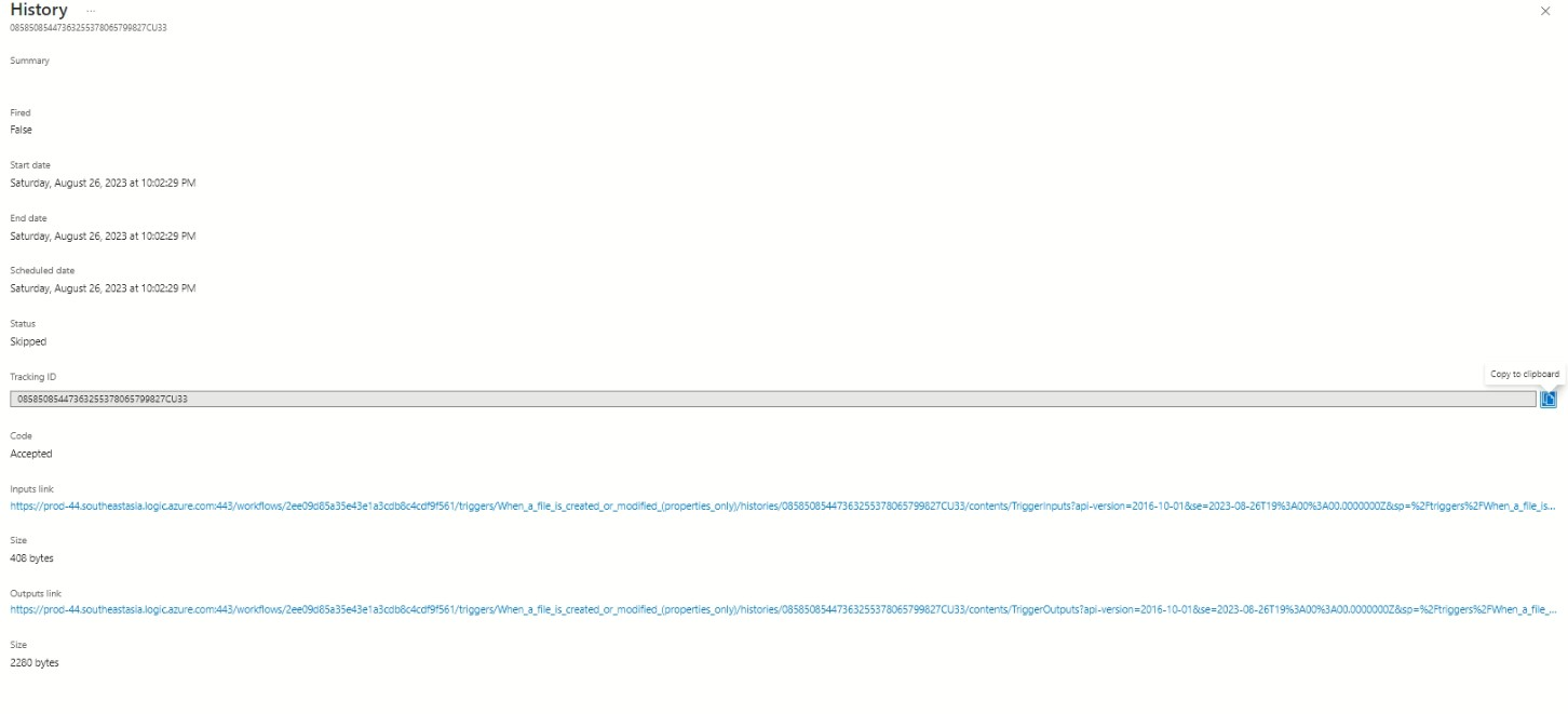

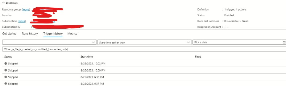

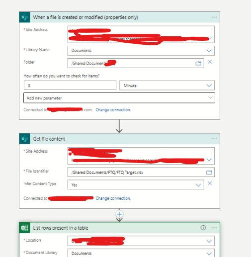

Good day! I am trying to build an Azure Logic Apps Consumption Type workflow; From SharePoint we will get the data in rows and will ingest it to SQL Server. The workflow ran successfully but it is giving 202 Status messages, and the trigger history is Skipped. Can you please advise what is wrong with our design?

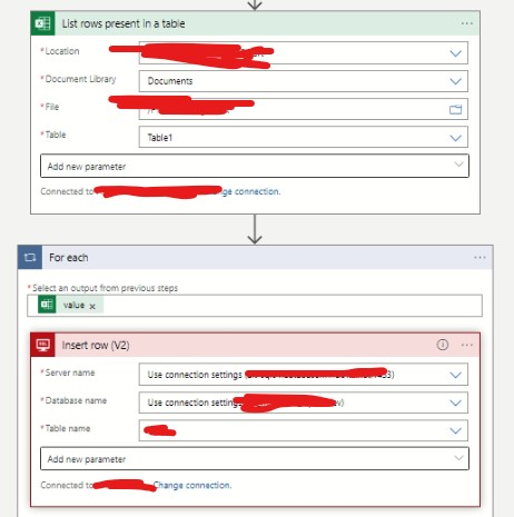

Please see the screenshot of the design and the output below. Thank you in advance for your help.
I tried to check the connection for SharePoint, Excel and SQL server and it was connected properly. I would like to know if there's any other blocker as to why it was skipper or not running.

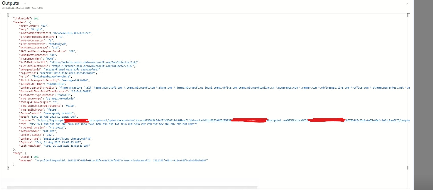

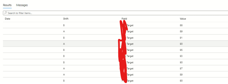

Here's the output:

    @Ceeeee-8261 Thanks for reaching out. If you are seeing Skipped in the triggered history then it means that the trigger condition was not met and the trigger did not fire. This can happen if the trigger is set up to only fire when certain conditions are met. If the incoming data does not meet these conditions, the trigger will be skipped and the Logic App will not run.
    Please click on three dots on your trigger --> Settings and validate if you have specified any Trigger Conditions which would have not met and your triggered got skipped.
