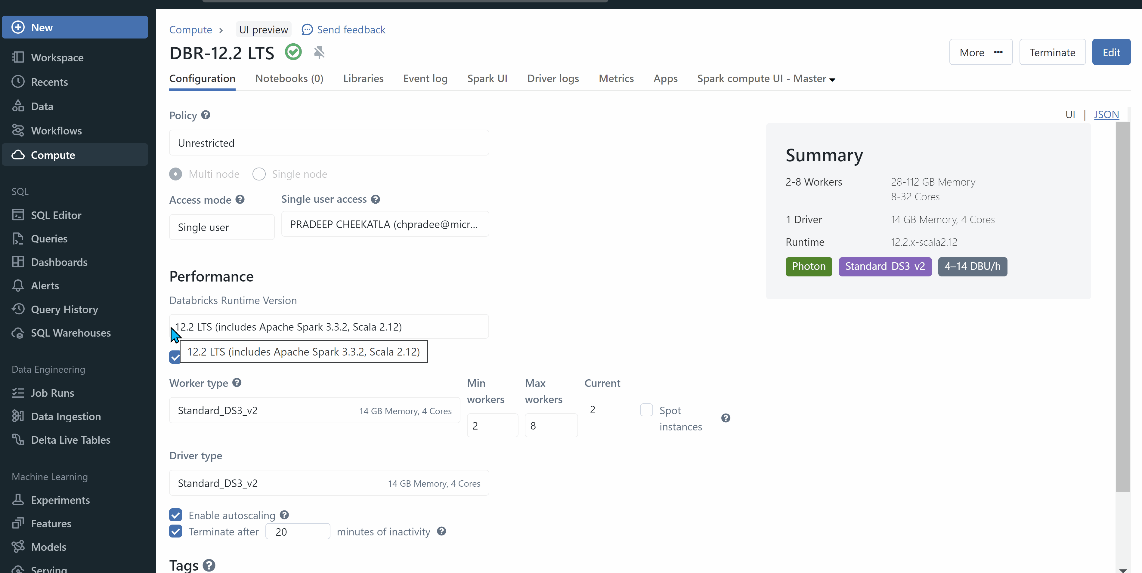

    As per the repro, I had tried to install the maven library (com.microsoft.azure:azure-eventhubs-spark_2.12:2.3.22) on Cluster Details - Databricks Runtime Version: 12.2 LTS (includes Apache Spark 3.3.2, Scala 2.12) and able to successfully able to install wihtout any issue.
    ADB-SparkEventHUbs
    In case, if you are still experiencing the same issue. I would suggest you to share the databricks runtime version which you are using to install the maven library.
