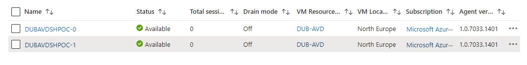

    1. Check the status of your Session Hosts to ensure they are showing as available:
    enter image description here
