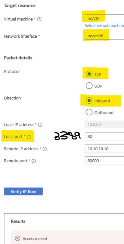

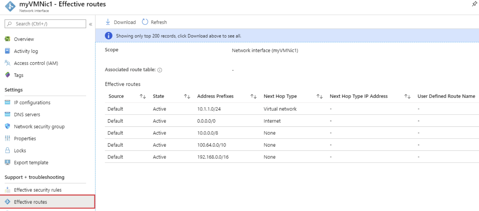

Hello my dears,
I tried to create a site 2 site between Azure and the on-prem site by using a local Fortigate device.
I did the Azure side and Fortigate side and connected, I can ping from Az VM to the local gateway on-prem(192.168.1.9). the status on FortiGate UP.
I need everyone on the on-prem site can connect to the VM.
All users can't ping or connect RDP on Az VM
