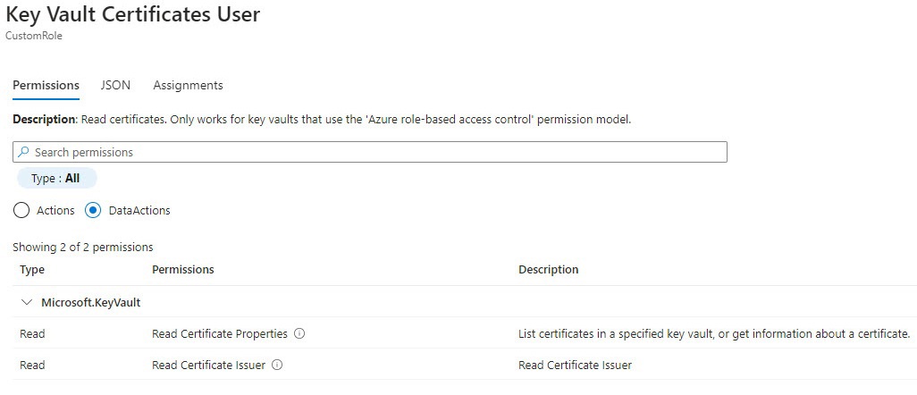

    Have you tried creating a Custom Role and assign that to your Apps?
    azure key vault certificates user custom role1
    Below is sample JSON to get you started (substitute your subscription ID):
        "properties": {
            "roleName": "Key Vault Certificates User",
            "description": "Read certificates. Only works for key vaults that use the 'Azure role-based access control' permission model.",
            "assignableScopes": [
                "/subscriptions/11111111-1111-1111-1111-111111111111",
                "/subscriptions/11111111-1111-1111-1111-111111111111/resourceGroups/*"
            "permissions": [
                    "actions": [],
                    "notActions": [],
                    "dataActions": [
                        "Microsoft.KeyVault/vaults/certificates/read",
                        "Microsoft.KeyVault/vaults/certificatecas/read"
                    "notDataActions": []
    It is likely that above permissions are insufficient so you should test, add more, test again, repeat until it is correct.
