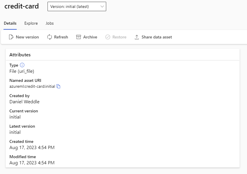

I started following along with the explore-data.ipynb notebook found under Samples > SDK v2 > tutorials > get-started-notebooks. At code cell [5] I am running into an error.
Here is the block of code:
import pandas as pd
# get a handle of the data asset and print the URI
data_asset = ml_client.data.get(name="credit-card", version=v1)
print(f"Data asset URI: {data_asset.path}")

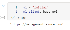

The data asset path prints fine on line 5. However, the second-to-last line pd.read_csv(data_asset.path) raises an error (below):
RuntimeError: StreamError(PermissionDenied(Some(AuthenticationError("AttributeError: 'MLClient' object has no attribute '_base_url'"))))
The kernel is set to Python 3.10 - SDK V2.
