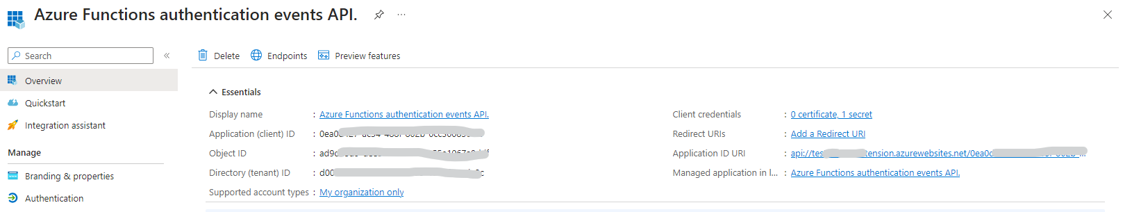

    As for the error you're seeing when trying to create a custom extension token issuance event, it looks like the resource ID you're using is not in the correct format. The resource ID should be in the format of 'api://testxxxxxextension.azurewebsites.net/0ea0d427-xxx-4xxxf-8xxx-xxxxxxxxx'
    .Make sure you're using the correct format for your resource ID.User's image
