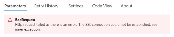

I have a standard logic app that has a HTTP Call to an Azure Function. It was working before and suddenly, it failed and raised error the "The SSL connection could not be established". I have already confirmed the the SSL certificate is valid. I also tried calling the http azure function outside logic apps and it is working. Can you tell me where/what else should I be checking?

    I understand you are facing an issue with a standard logic app that has an HTTP call to an Azure Function. The HTTP call was working before but suddenly failed and raised an error The SSL connection could not be established.
