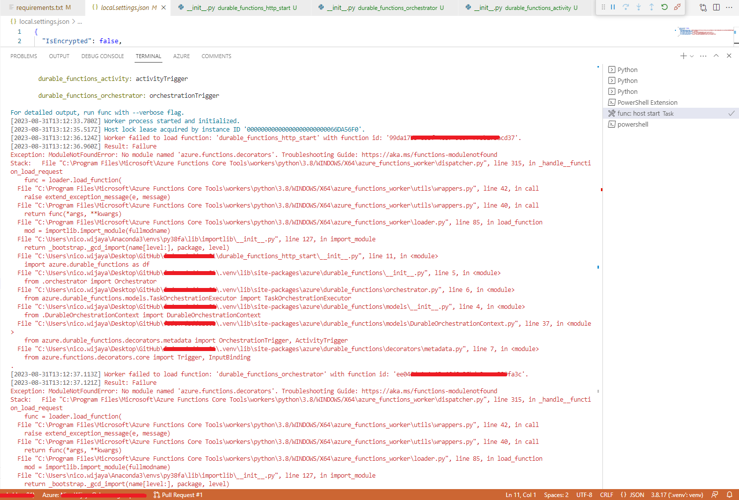

However, when I started debugging it always ended with this error below.
Result: Failure
Exception: ModuleNotFoundError: No module named 'azure.functions.decorators'.User's image
I checked and ensure I'm using the correct venv and it has the latest version of azure-functions & azure-functions-durable, but the problem persists.

    Nico Wijaya Thanks for sharing the info. In V2 programming model, triggers and bindings are represented as decorators. As per Requirements doc, you need to have minimum Azure Functions Core Tools version v.4.0.5095+ for running locally, you have older version (latest: 4.0.5198).
    Suggest you update it to the latest and follow Enable v2 programming model step to set AzureWebJobsFeatureFlags. Let me know if you still face the issue after that.
