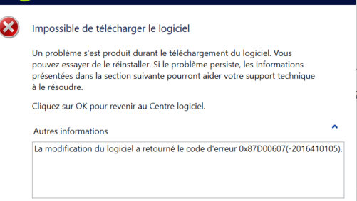

i can see the package in software centre, but when i try and run it it says :The software could not be found on any servers at this time. (Not sure if this issue is realted because the client is having issues communicating with the site)

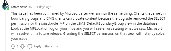

    I created a MS support case for this issue, but found this threads on Reddit today:
    https://www.reddit.com/r/SCCM/comments/14zit9o/upgraded_to_2303_and_updates_are_stuck_i
    https://www.reddit.com/r/SCCM/comments/16jfypn/cmg_and_clients_not_in_boundary_groups_cant/
    Have tested it and it has solved our issue, waiting now for confirmation of MS if that is the right way to fix it.

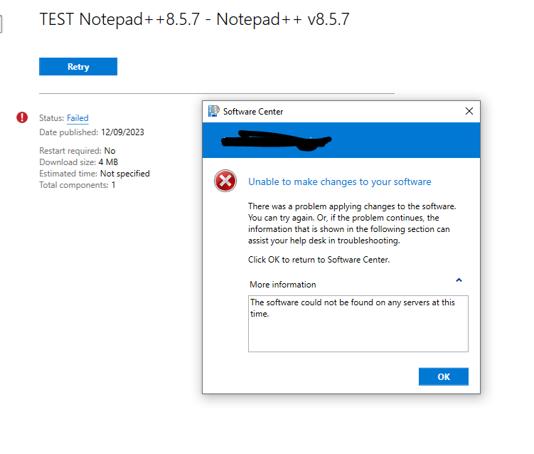

    .... and on another (less important) note -none of them are pulling my software package (notepad++) from the Cloud DP either
    Its distributed to the CDP, clients have the setting enabled in clients settings to use CDP but when i try and run it it says this:

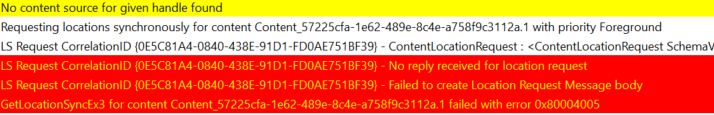

    LS Request CorrelationID {549CC2E5-3CB8-473A-9369-AB7390A5707B} - LSSendLocationRequestSync sending location request message ContentAccess 12/09/2023 13:39:50 17596 (0x44BC)
    LS Request CorrelationID {549CC2E5-3CB8-473A-9369-AB7390A5707B} - No reply received for location request ContentAccess 12/09/2023 13:39:50 17596 (0x44BC)
    hr, HRESULT=80004005 (K:\dbs\sh\cmgm\0405_083130\cmd\1d\src\Framework\LocationServices\LSInterface\ccmpkglocation.cpp,196) ContentAccess 12/09/2023 13:39:50 17596 (0x44BC)
    LS Request CorrelationID {549CC2E5-3CB8-473A-9369-AB7390A5707B} - Failed to create Location Request Message body ContentAccess 12/09/2023 13:39:50 17596 (0x44BC)
    RequestLocationsSync(sContentID, sContentVersion, Type, ulPriority, ui64DeploymentFlags, ulTimeoutMilliseconds, ulClientInOperation, pl, paDP, pContentInfo), HRESULT=80004005 (K:\dbs\sh\cmgm\0405_083130\cmd\1d\src\Framework\LocationServices\LSInterface\ccmpkglocation.cpp,609) ContentAccess 12/09/2023 13:39:50 17596 (0x44BC)
    spICCMPkgLocation->GetLocationsSyncEx3( pwszContentId, pwszContentVersion, eContentType, dwLSPriority, ui64DeploymentFlags, dwLocationTimeoutInSeconds1000, 0xFFFFFFFF, &ulDPCount, &paDP, pContentInfo), HRESULT=80004005 (K:\dbs\sh\cmgm\0405_083130\cmd\m\src\client\SoftMgmtAgent\ContentAccess\ContentAccessService.cpp,1393) ContentAccess 12/09/2023 13:39:50 17596 (0x44BC)*
    GetLocationSyncEx3 for content 00100430.3 failed with error 0x80004005 ContentAccess 12/09/2023 13:39:50 17596 (0x44BC)
