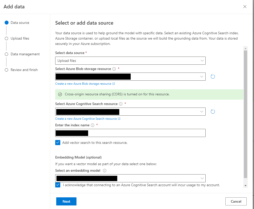

I added a datasource in the chat playground of Azure OpenAI Studio with the "upload files" option. I created a new Azure Cognitive Search Resource in the "Basic" tier, enabled vector embedding, and assigned a deployed ada 002 model to embed document chunks.

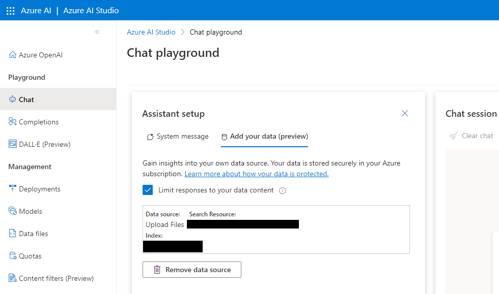

On the next screen I uploaded a 1.8mb text file of tab-delimited data, and selected "Vector" search (not Vector+simple and not Vector+semantic). It took 5 minutes to chunk and embed the document and seemed to finish succesfully. I can now get some answers from the document in the chat.
