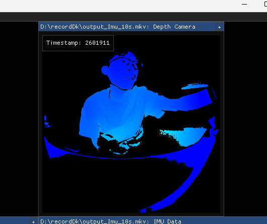

Today, I use kinect to record a video. And then I use Azure Kinect Viewer to check the depth(like figure in the below).
Snipaste_2023-09-02_14-54-35
But when I use ffmpeg to extract all the depth map, I found that all of that are black. I don't know why?
Snipaste_2023-09-02_14-53-23
This is my cmd log:

  1. AshokPeddakotla-MSFT 35,971 Reputation points Moderator
    2023-09-05T04:15:48.6866667+00:00
    Jianxin xiao Greetings!
    The viewer normalizes the depth based on depth modes min and max depth so that the entire 16bit depth range is used. Then it uses the following code to colorize.
    static inline BgraPixel ColorizeBlueToRed(const DepthPixel &depthPixel,
                                                  const DepthPixel &min,
                                                  const DepthPixel &max)
            constexpr uint8_t PixelMax = std::numeric_limits<uint8_t>::max();
            // Default to opaque black.
            BgraPixel result = { 0, 0, 0, PixelMax };
            // If the pixel is actual zero and not just below the min value, make it black
            if (depthPixel == 0)
                return result;
            uint16_t clampedValue = depthPixel;
            clampedValue = std::min(clampedValue, max);
            clampedValue = std::max(clampedValue, min);
            // Normalize to [0, 1]
            float hue = (clampedValue - min) / static_cast<float>(max - min);
            // The 'hue' coordinate in HSV is a polar coordinate, so it 'wraps'.
            // Purple starts after blue and is close enough to red to be a bit unclear,
            // so we want to go from blue to red.  Purple starts around .6666667,
            // so we want to normalize to [0, .6666667].
            constexpr float range = 2.f / 3.f;
            hue *= range;
            // We want blue to be close and red to be far, so we need to reflect the
            // hue across the middle of the range.
            hue = range - hue;
            float fRed = 0.f;
            float fGreen = 0.f;
            float fBlue = 0.f;
            ImGui::ColorConvertHSVtoRGB(hue, 1.f, 1.f, fRed, fGreen, fBlue);
            result.Red = static_cast<uint8_t>(fRed * PixelMax);
            result.Green = static_cast<uint8_t>(fGreen * PixelMax);
            result.Blue = static_cast<uint8_t>(fBlue * PixelMax);
            return result;
    Reference :
    https://github.com/microsoft/Azure-Kinect-Sensor-SDK/blob/95f1d95f1f335b57a350a80a3a62e98e1ee4258d/tools/k4aviewer/k4adepthpixelcolorizer.h#L35
    Also, see Using third-party tools and let me know if that helps.
