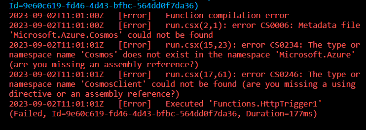

I am trying to use Microsoft.Azure.Cosmos within azure function app with binding CosmosClient as an input but i am getting error messages and it isn't working.
Can you help me to get it work, please?
