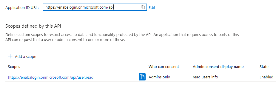

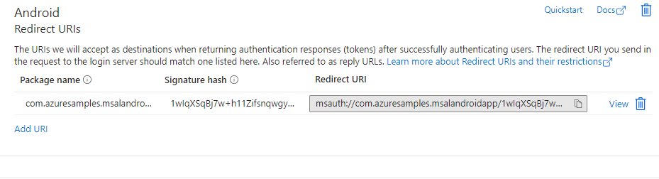

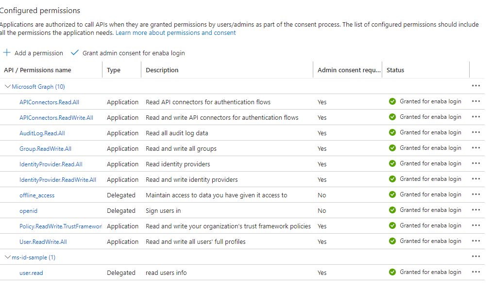

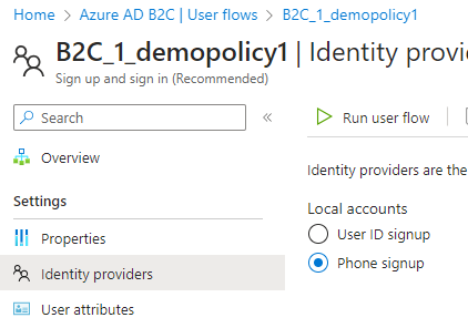

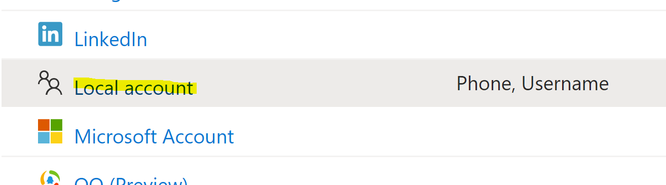

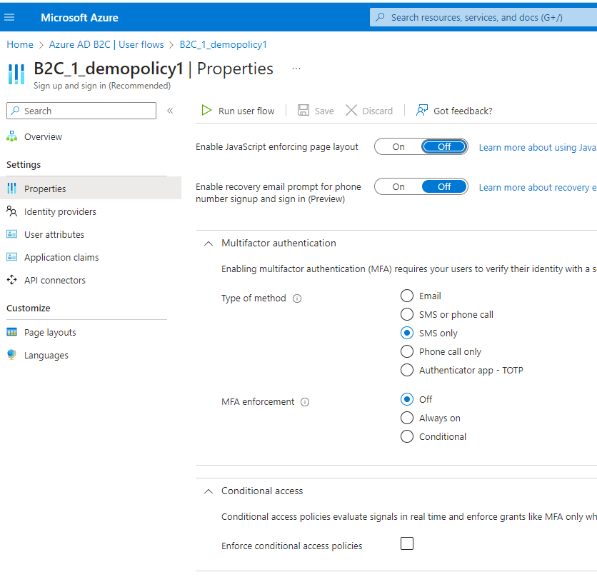

I managed to get an access token using a phone sign Up without the password
so when I tried to call MS Graph it gave an error
i setup all permission and scope from Azure portal

    Based off your error message and screenshots, it looks like you set everything up correctly since you're able to get the Access Token using Phone signup. However, to gain a better understanding of your issue, can you share some more details below.
    • What Graph API call are you trying to make with the access token?
    • After receiving the access token - did you verify it using a JWT decoder? https://jwt.ms/
    • Can you share any documentation that you followed to set this up?
    Any additional information would be greatly appreciated!
