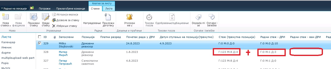

i need a formula in calculated column for sum of two columns that are the type text. the format in text column is Г:2 М:05 Д: 10. the formula would works next: Г:2 М:05 Д: 10 + Г:5 М:03 Д: 1 = Г:7 М:08 Д: 11
Г is year
M is mounth
D is day
can you help me?

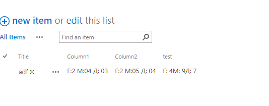

    Per my test, you can use MID to extract the numbers and use CONCATENATE to connect string and the calculate result, please refer to following formula
    CONCATENATE("Г: ",MID(Column1,3,2)+MID(Column2,3,2),"М: ",MID(Column1,7,2)+MID(Column2,7,2),"Д: ",MID(Column1,13,2)+MID(Column2,13,2))
