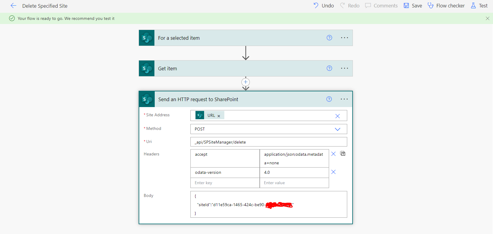

Hi all, I have a super simple flow that is manually triggered. The objective of the flow is to delete a Non-Group Connected SharePoint site. I have used the official Microsoft documentation on how to use the REST API, but I keep getting Error 400, bad request errors every time I run the flow when trying to send an http request. I have attached a photo to show the step involved. All of the code, as far as I'm aware, is exactly as the documentation states. but I cannot seem to get the step to complete successfully. There seems to be lots of people having success with group connected SharePoint sites, but as far as I'm aware that's a different process.
NOTE: For the Site Address input, I have tried the URL dynamic content (within screenshot), as well as manually typing the admin centre URL and also manually typing the URL of the site wanting to be deleted. None of the three work.Capture

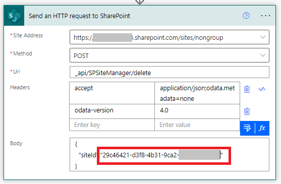

    1, The site used for test:
    2, Get the site ID. Here I use graph to obtain it, you can refer to it.
    Go to Graph Explorer, and input like this: https://graph.microsoft.com/v1.0/sites/tenant.sharepoint.com:/sites/sitename?$select=id
    Then put the site ID into the body.
    09144

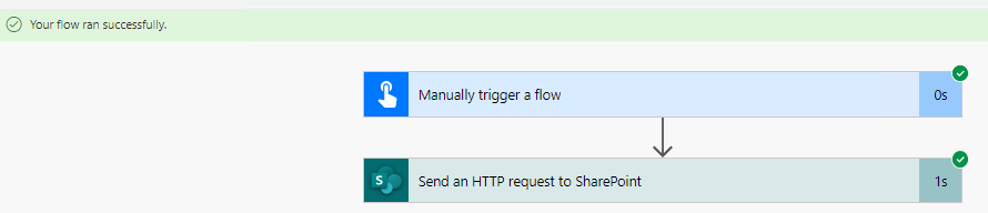

    Run the flow and get success:
    09145

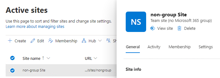

    Double check the site has been deleted:
    09146

    I am a SharePoint support engineer, and your question is also related to SharePoint Development, which is not my field of expertise, so I add a related tag so that your question can be seen by SharePoint Development engineers. Regarding your question, I conducted research and testing and got the same results as you. However, I went to the SharePoint admin center to check, and the site has been successfully deleted. You can check to see if the site has been deleted. Because power automate and SharePoint Development are not my areas of expertise, I don't know why this result occurs.
