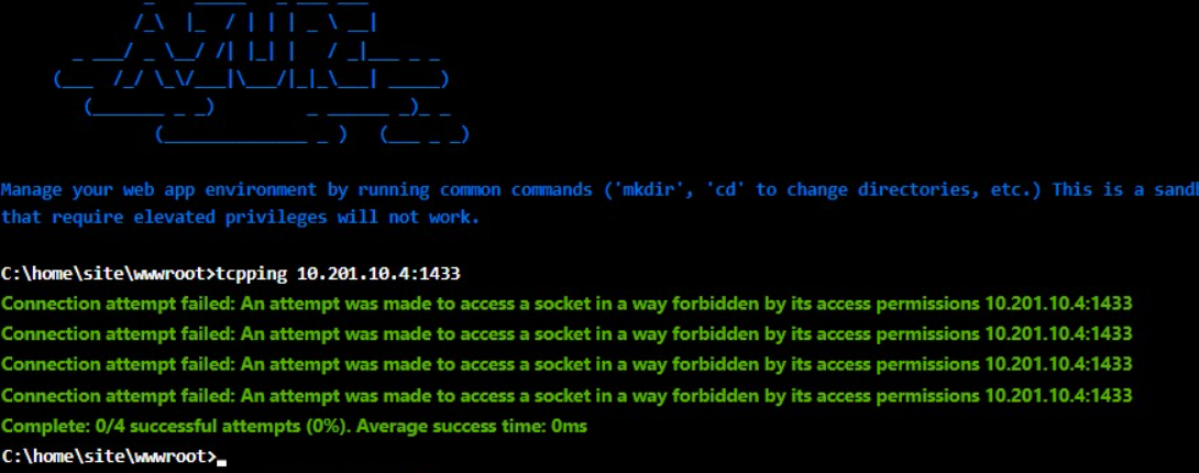

Hello,
today one of our app having error and when i check connectivity from the app to the database server i got 'connection attempt failed' like below picture.User's image

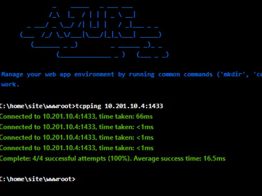

Then i disconnect the vnet integration and recreate and the app can successfull connect to the database server. Sometimes i always facing this issue, the vnet should be recreated and the app working normally. Anyone know why this happened?
