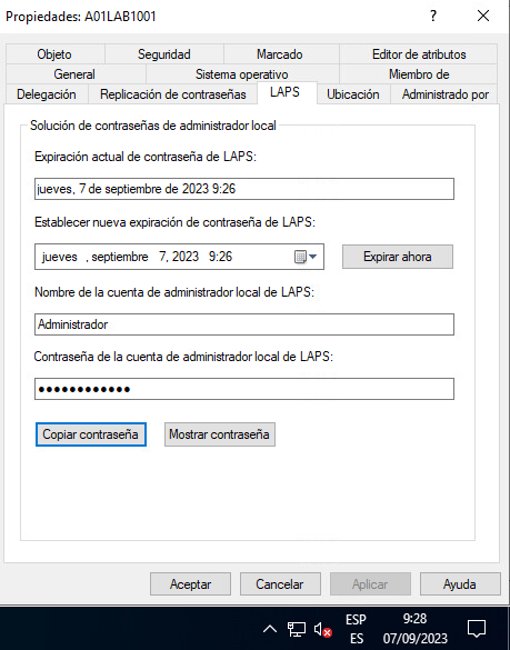

Good morning,
We are testing the new LAPS (2023), but when I click "expire now" in the LAPS tab of the team object, the password does not expire and remains the same. It only expires or changes the password of the computer in question, when I run "gpupdate /force" on the computer itself.
It is also not worth performing a "group policy update" on the organizational unit in which the computer is located.
Does anyone know if this is normal?
The domain has 3 Windows Server 2022 DCs, and the client is Windows 10.
Thank you very much for your collaboration.

    LAPS automatically randomizes the local administrator password on all domain computers with LAPS activated and changes each password regularly.
    If the expiration period has passed, the LAPS Group Policy Client Side Extension just checks the expiration date that is saved in AD, and the LAPS will update on the subsequent GP refresh.
    In other words, if the password validity period is one year, it has been in use for that length of time.
    Set the expiration time right away using the LAPS UI, and the LAPS will update once the next GP refresh occurs.
