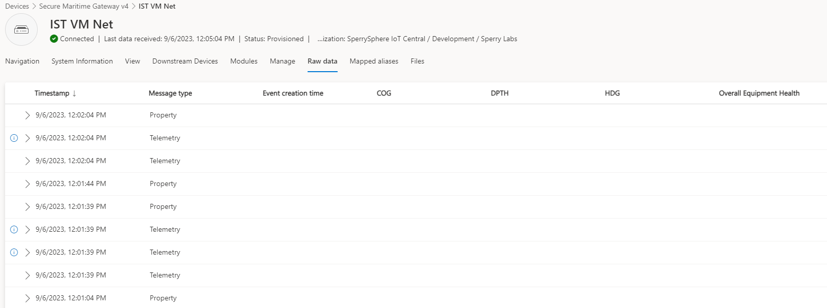

I'm not seeing any mapped raw data entries for IoT Edge devices, but I do see raw data for devices that aren't IoT Edge enabled.
IoT Edge device with no mapped raw data:IoT Edge device not showing data

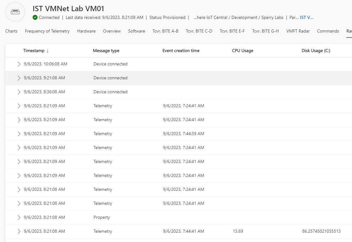

Standard device showing mapped raw data:
Standard device showing raw data

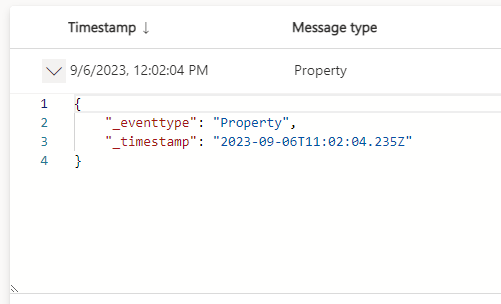

Furthermore, if I expand an event that was sent (in this case a property that is being set correctly as I'm showing it in one of the device views), the content is empty - no mapping to the property and no unmodelled data:Reported property event with no data

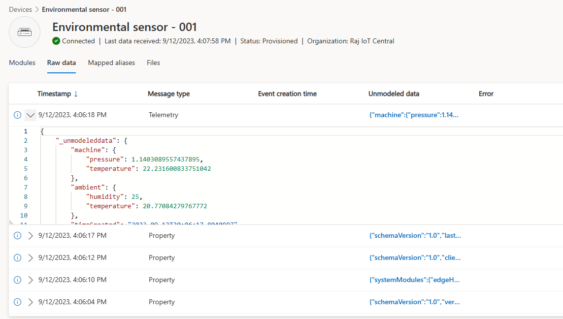

    Hi @Matthew Pass Greetings! I have tested the tutorial link you have shared Connect an IoT Edge device to your Azure IoT Central application and could view the raw data under the IoT Central device pane. Please review the below images.
    Scenario 1: No device template assigned
    Screenshot 2023-09-12 160812
    Since there is no device template assigned, the data is categorized as unmodeled data.

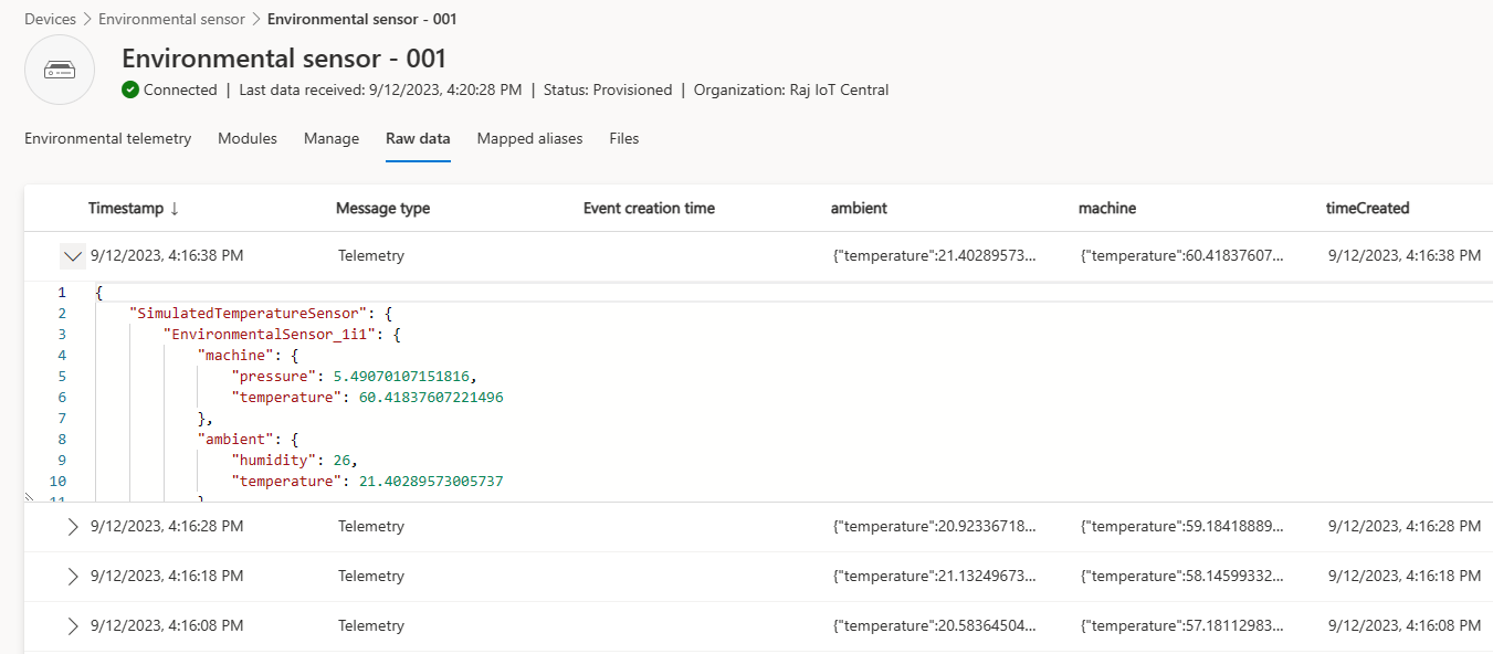

    Scenario 2: After assigning the device template
    I could see the raw data in the appropriate fields. Please let us know if this is not your observation when you tested the edge device by following the steps in the tutorial.
