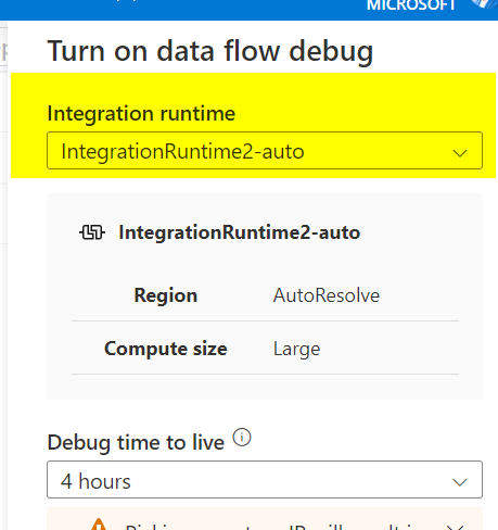

I'm a little confused. I'm budgeting a solution that uses Azure Data Factory and Synapse, so I use the Azure Price Calculator. These are my questions:

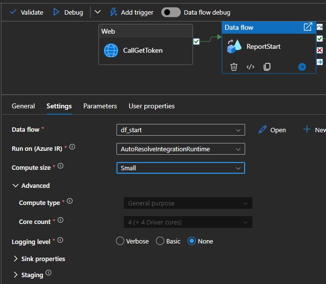

¿The cluster used in debug session is different from the specified in the integration runtime? I ask this because I see two configuration clusters, that is:
ir-setup
dataflow activity
I get confused with these two configurations.
¿How is it billed?

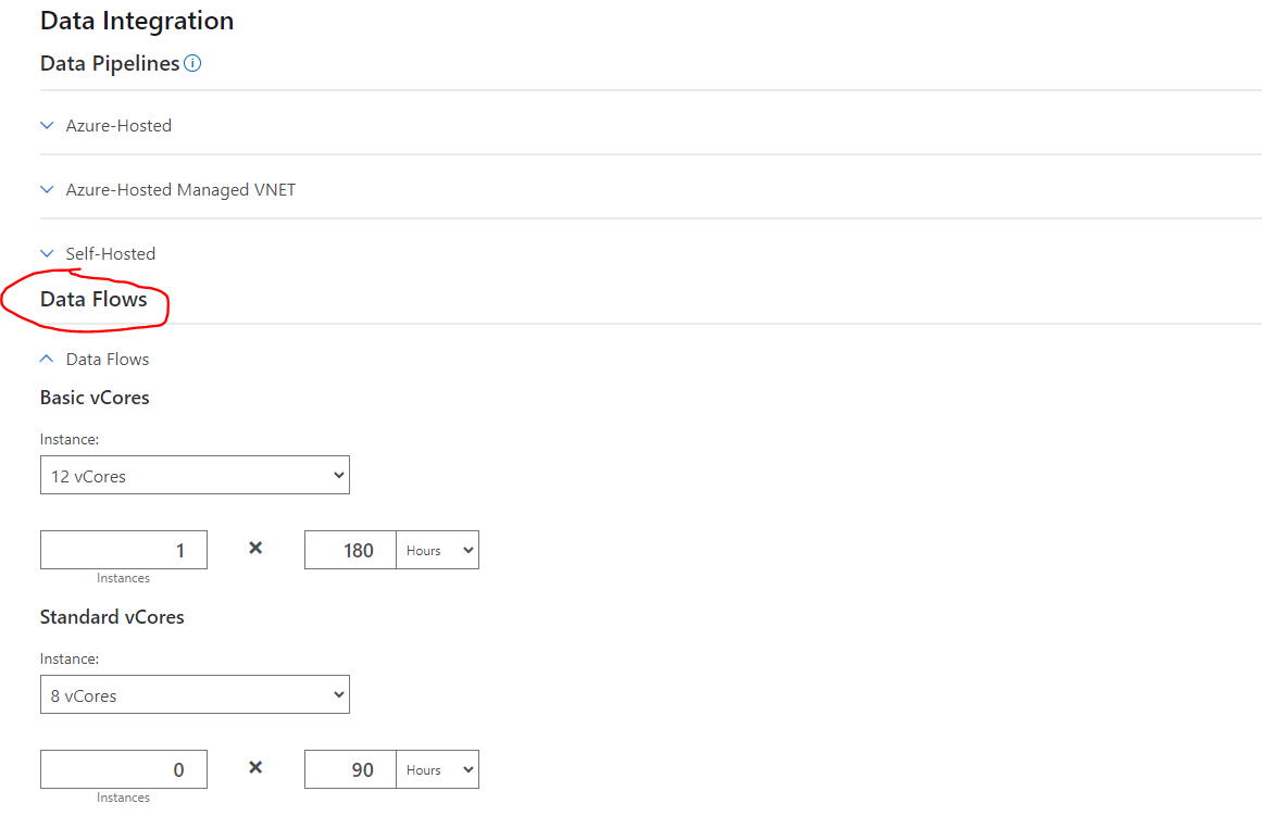

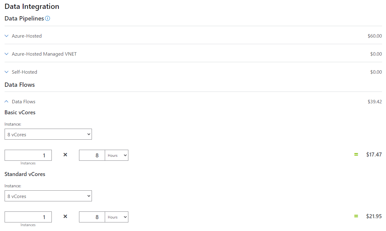

When using Azure Calculator, I just got this:
calculator
The first time I said: "Ok, here I can price the spark cluster". but when I consult here, Azure Calculator expresess in terms of vCores and the docs say "nodes"

    Yes, The cluster(IR) used in the debug session is different from the one specified in the dataflow integration runtime
    (Or) You can use the same IR on the "dataflow debug" session.

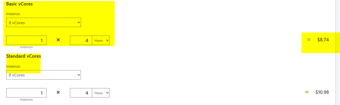

    When you enable "dataflow debug", You will be charged on that particular IR for the duration.
    Ex:
    When you turn on "Data flow Debug" on the integration runtime drop-down, you can choose one of the existing IRs you already created.
    If you choose the debug time to live = 4 hours for a small cluster, you will be charged for the 4 hours on that IR.
    So your charge on the "dataflow debug" is as follows:
    small cluster = 8 Vcores
    total time = 4 hrs
    1 debug session = 1 instance
    total cost = 1 instance * 4 hours
    Considering your cluster is using basic V-cores, then the cost would be = $8.74 (for the dataflow debug session)
    My understanding is Basic Vcores are used on the auto IR. (but this is not documented). The billing team can confirm this if you need more details on it.

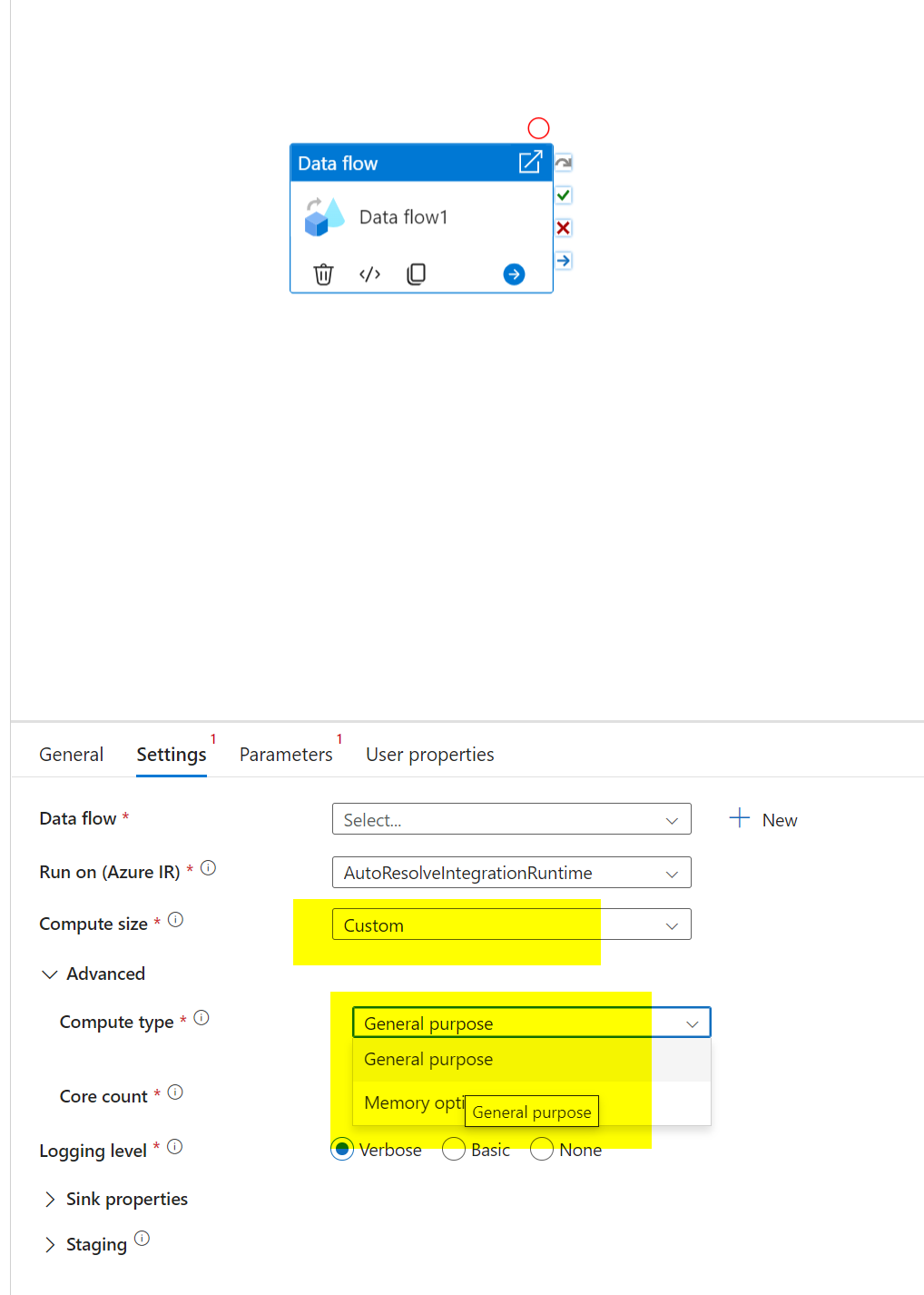

    For your question on the document:
    "Nodes" in the document is nothing but the cluster size( small, medium, large etc)
    Small node = 4 driver nodes + 4 worker nodes = 8 Vcores

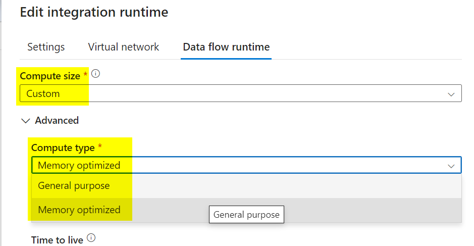

    Coming to IR on the dataflow:
    You can also choose the existing IR from the drop-down or create a new IR here. IR is nothing but compute to run the activities.
    The price varies depending on the IR size- small, medium, large etc. Small nodes have fewer Vcores compared to medium or large nodes.
    The same above formula applies to the Dataflow IR as well.
    Ex: If your data flow ran for 4 hours with a small cluster, the price would be the same as above.
