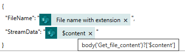

    Make sure in your logic app when you are appending the array variable of files you need to pass the $content
