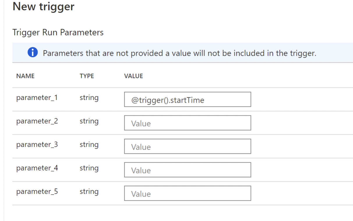

Why Azure data factory does not show any system variables & functions for trigger parameters as it shows in case of pipeline parameters such as date formatting functions and system output variables etc ?
Muhammad Umer 20 Reputation points
2023-09-08T10:03:55.5533333+00:00
It becomes difficult to find the system variables and functions and this also increases the chance of errors.
For example, @{formatDateTime(trigger().scheduledTime, 'yyyy-MM-dd HH:mm:ss')}
In my case, it was not easy to know how I can get the start time of trigger by ADF itself.

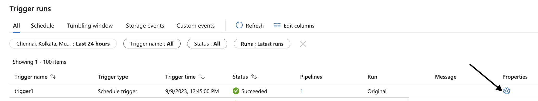

    In order to know about the properties of triggers, we can use the properties icon in the monitor tab and trigger runs. Below is a sample for a scheduled trigger execution.
    Screenshot 2023-09-10 at 8.35.30 AM

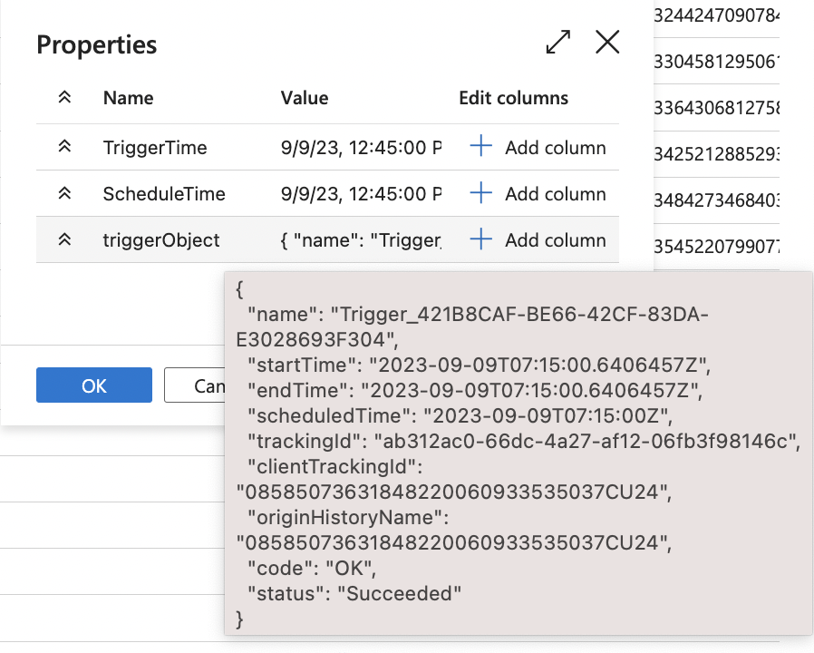

    If you click on Properties, we will get to see all the properties like below.
    Screenshot 2023-09-10 at 8.36.07 AM
    From the above screenshot, we can infer that, below properties can be used with the @trigger() method, like, @trigger().<property_name> where property_name could be name, startTime, endTime, scheduledTIme, trackingId, clientTrackingId, code and status.
      "name": "Trigger_12348CAF-BE66-42CF-83DA-E3028693F304",
      "startTime": "2023-09-05T18:00:22.4180978Z",
      "endTime": "2023-09-05T18:00:22.4180978Z",
      "scheduledTime": "2023-09-05T18:00:22.507Z",
      "trackingId": "1234a112-7bb9-4ba6-b032-6189d6dd8b73",
      "clientTrackingId": "12346637084630521889360938860CU33",
      "code": "OK",
      "status": "Succeeded"
