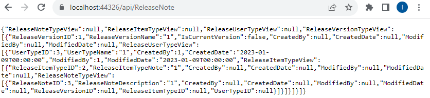

and i am getting the response :
 {     "ReleaseNoteTypeView": null,     "ReleaseItemTypeView": null,     "ReleaseUserTypeView": null,     "ReleaseVersionTypeView": null }
don't know where is the mistake

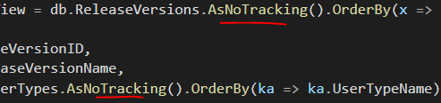

    First, there is no ReleaseItemTypeName parameter in ReleaseItemTypeView.
    Remove AsNoTracking() method.
