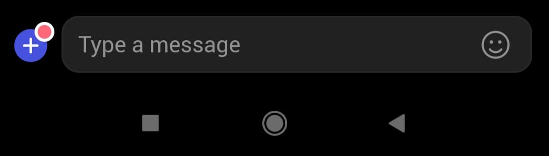

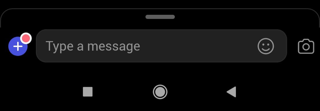

Hi I am trying to get speech input from users in my Azure Bot.
following the documentation, I have added devicePermission media to my Azure Bot manifest and uploaded it to teams. This has enabled the camera icon but the microphone icon is still disabled/not visible.
PFA screenshots
without media permissions -without_media
with media permission -with_media
Please let me know if I am missing anything. It is a client requirement to be able to send speech messages to the Azure Bot

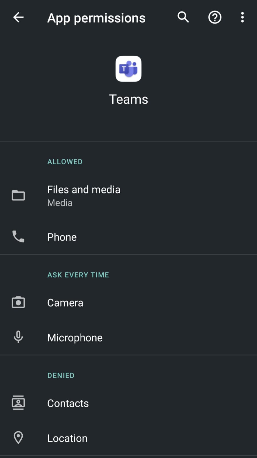

    2.User permissions: Users may need to manually grant microphone access permissions in their browser settings. In some cases, users may need to explicitly allow microphone access for Teams.
    As you are using mobile devices, you can manage device permissions in Teams settings by selecting Allow or Deny permissions to specific apps.
