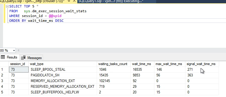

  1. Erland Sommarskog 121.9K Reputation points MVP Volunteer Moderator
    2023-09-12T20:42:55.1833333+00:00
    The top wait is SLEEP_BPOOL_STEAL, you can read about it here: https://www.sqlskills.com/help/waits/sleep_bpool_steal/
    This suggests that you are short on memory. How much memory is there in the machine? What does sp_configure 'max server memory' say? How big are the tables in megabytes?
