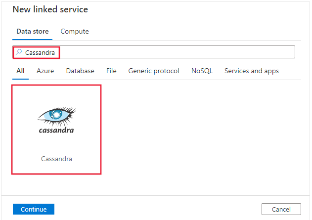

    Can you use existing Cassandra connector to connect to the Azure Managed instance for Apache Cassandra. As your Managed Instance for Apache Cassandra resides within a Virtual Network (Vnet), you have to create a Self-Hosted Integration Runtime (SHIR) to establish a connection to it. You can either host SHIR within the same Vnet as the Cassandra instance or ensure that the Vnet of Cassandra and SHIR are configured to communicate with each other (Vnet Peering).
    Cassandra_Connector

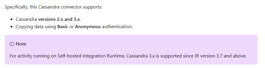

    You also need to make your Azure Managed instance for Apache Cassandra is on Supported version:
    connectorsupport
