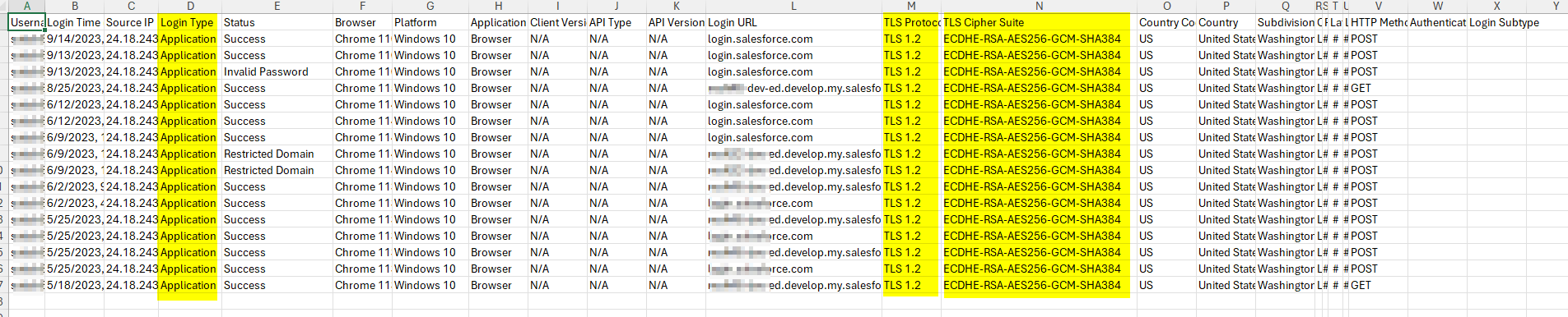

  2. QuantumCache 20,676 Reputation points Moderator
    2023-09-13T21:09:37.3566667+00:00
    Hello @Ram Babu Thanks for reaching out on this forum.
    Could you please specify which Azure Resource is involved here?
    Is it Azure Data Factory's Pipeline or Data Flow?
    Is it Azure Synapse Pipeline?
    Could you please add any screenshots of the error from the pipeline if possible?
    Please let us know how was the connection established from the linked Service?
    Looks like you are not using any SHIR (Self Hosted IR), or Private endpoints, right?
    --as asked by Amira in previous comment!
    Also please check what do you see in the login history of the user on the Salesforce side, when the error encountered with ADF pipeline?
    The login history on Salesforce side will give more details about the TLS...
