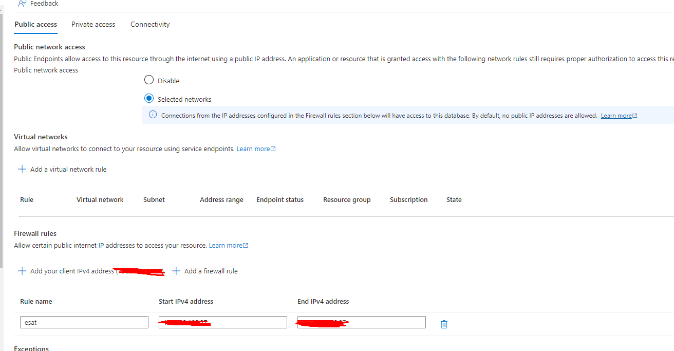

Hello, firstly sorry for my english. I want to connect my azure sql server but it wants to add ip to firewall, but i will share my project with my friends and teachers. So I don't want to add everyone,The person making the request should be able to access the values ​​directly. How can i do that ? Basically i want to disable network firewall. User's image

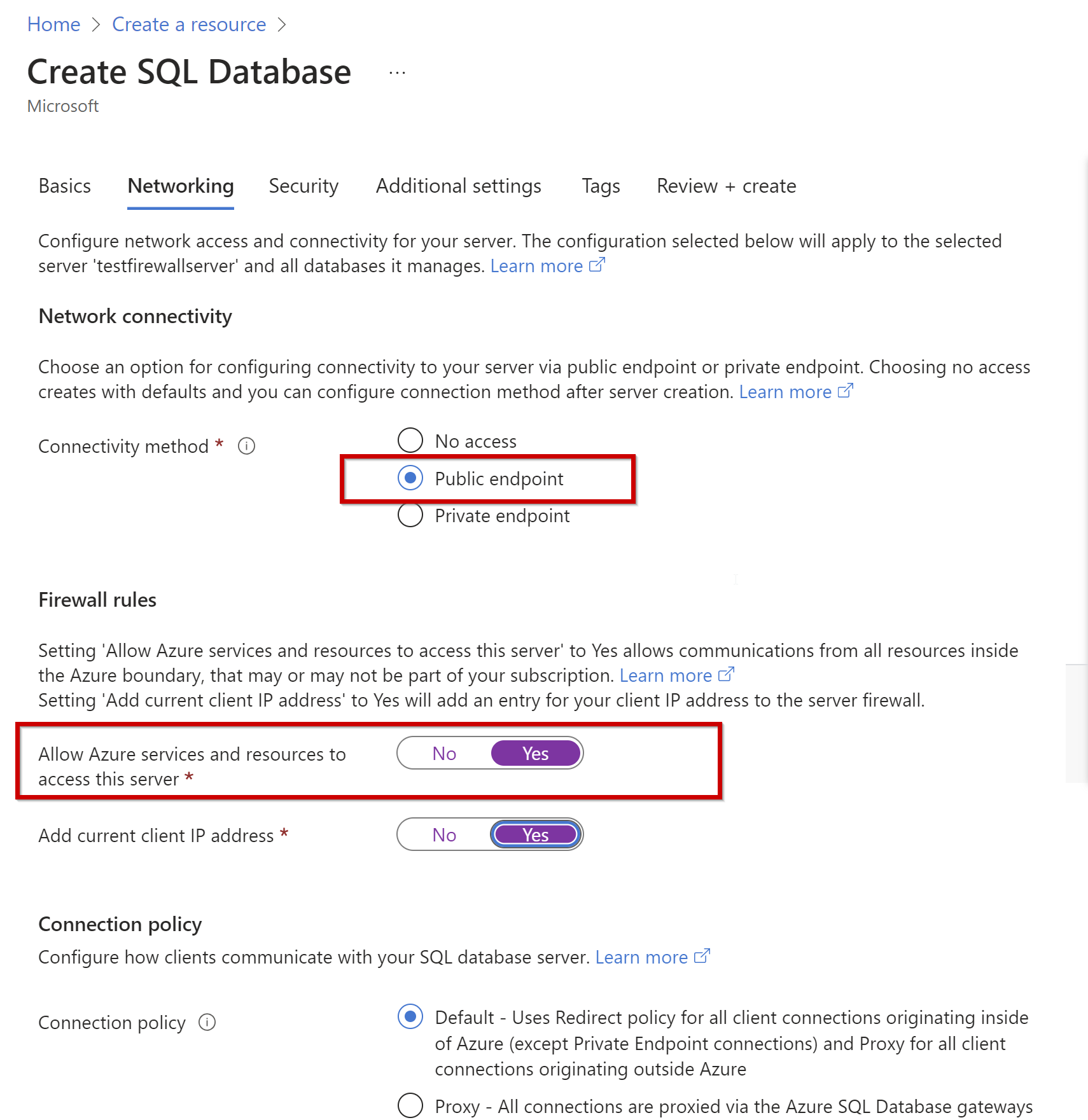

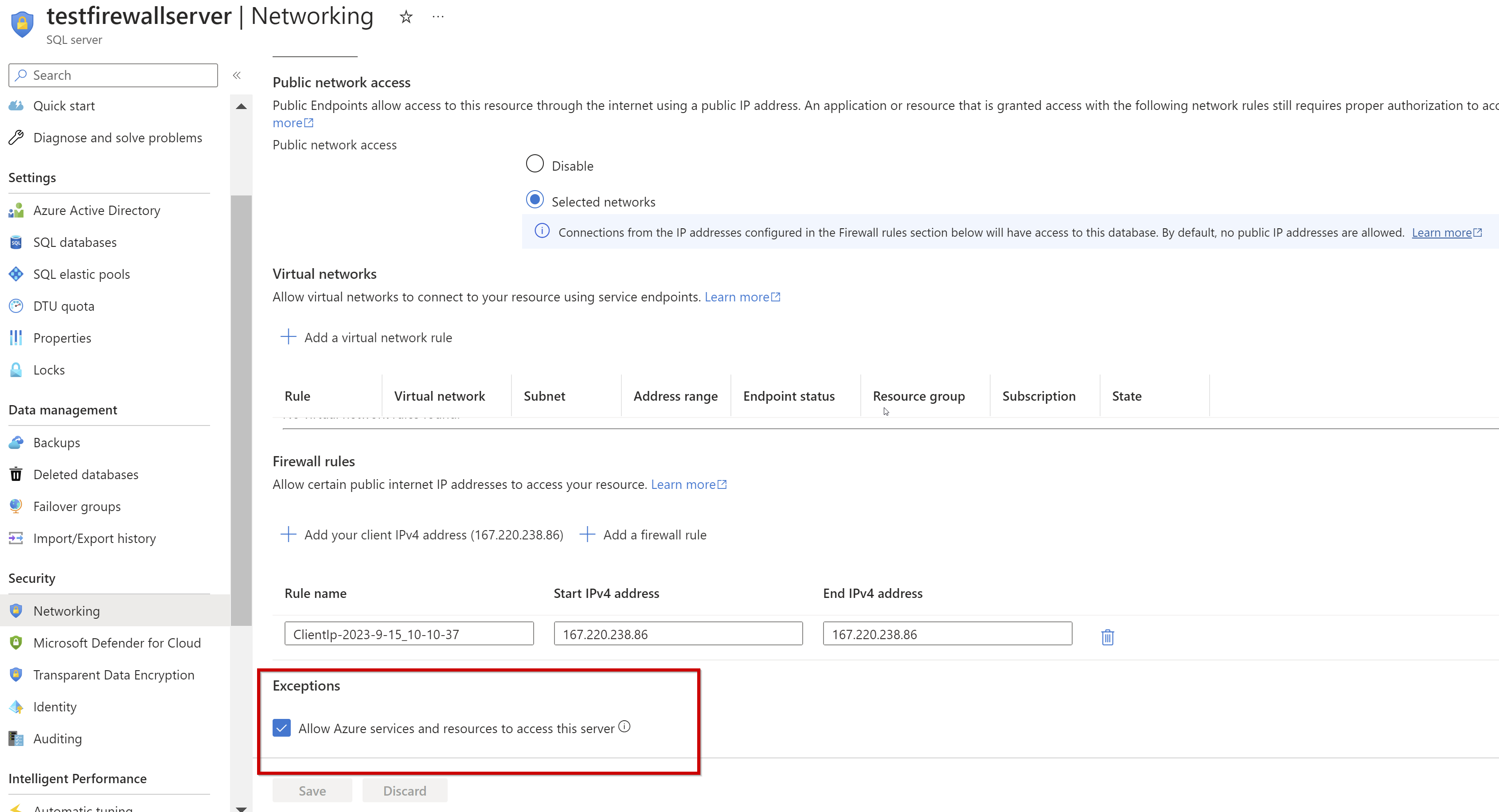

    As I understand, you want to make Azure SQL DB globally accessible.
    Could you please check the Network settings of the SQL Server of the Azure SQL Database:
    Try below setting so that it accessible by all Azure Services:
    When Allow Azure services and resources to access this server is enabled, your server allows communications from all resources inside the Azure boundary, that may or may not be part of your subscription.
    For more details refer: https://learn.microsoft.com/en-us/azure/azure-sql/database/firewall-configure?view=azuresql
    Let us know if this helps in your case. If not let us know what the requirement is with more details.
