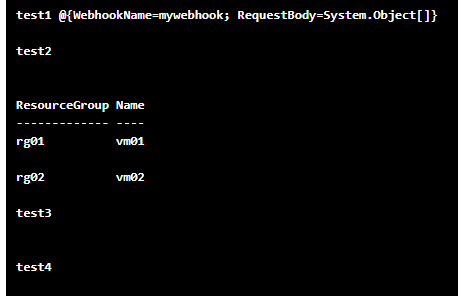

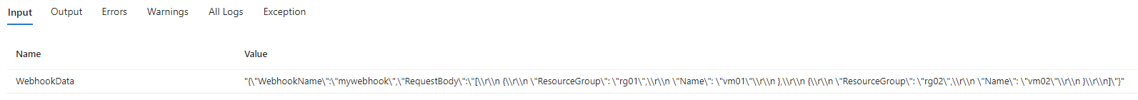

  1. David Cassady 6 Reputation points
    2024-10-18T14:02:44.8066667+00:00
    UPDATED
    Moral of the story - you need to check if input is an object (how it will appear coming from webhook) or a string (how it will appear coming from the UI). If it's a string, use ConvertFrom-Json to get an object.
    Passing the below JSON to the UI will work.
    {"WebhookName":"mywebhook","RequestBody":[{"ResourceGroup": "rg01","Name": "vm01"},{"ResourceGroup": "rg02","Name": "vm02"}]}
    Tested with your script and JSON input. It does not function the same.

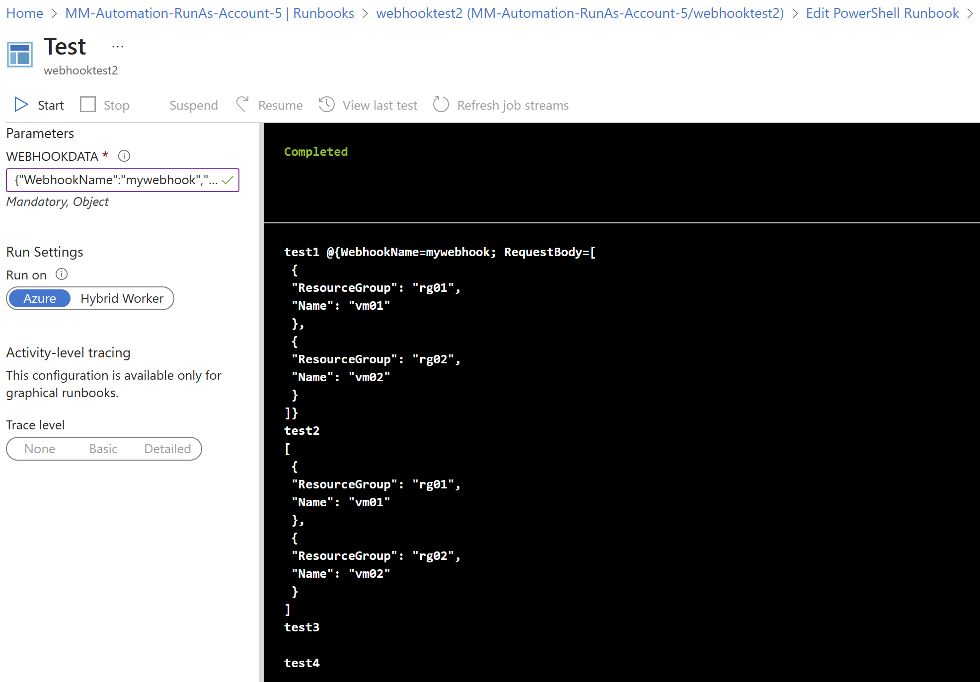

  2. tbgangav-MSFT 10,431 Reputation points Moderator
    2023-09-20T07:59:30.4066667+00:00
    Hi @Gaurav Garg ,
    As explained here, for the WebhookData parameter in the UI for testing in Test pane of the runbook, you must pass the data in JSON object with carriage returns and newline characters, so it matches the format that is passed in from a webhook.
    For example, pass the following sample JSON object in the UI for the WebhookData parameter for a sample runbook shared below.
    {"WebhookName":"mywebhook","RequestBody":"[\r\n {\r\n "ResourceGroup": "rg01",\r\n "Name": "vm01"\r\n },\r\n {\r\n "ResourceGroup": "rg02",\r\n "Name": "vm02"\r\n }\r\n]"}

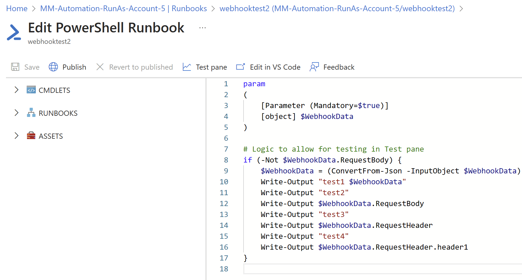

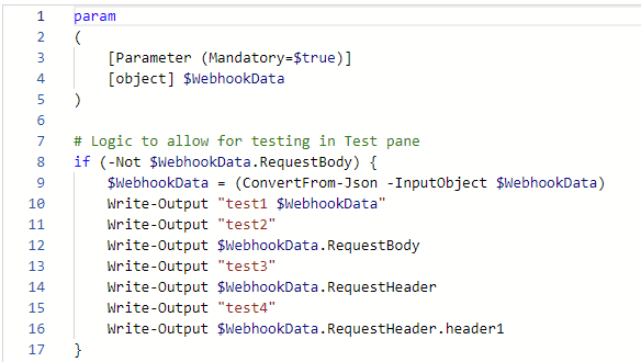

    param
        [Parameter (Mandatory=$true)]
        [object] $WebhookData
    # Logic to allow for testing in Test pane
    if (-Not $WebhookData.RequestBody) {
        $WebhookData = (ConvertFrom-Json -InputObject $WebhookData)
        Write-Output "test1 $WebhookData"
        Write-Output "test2"
        Write-Output $WebhookData.RequestBody
        Write-Output "test3"
        Write-Output $WebhookData.RequestHeader
        Write-Output "test4"
        Write-Output $WebhookData.RequestHeader.header1

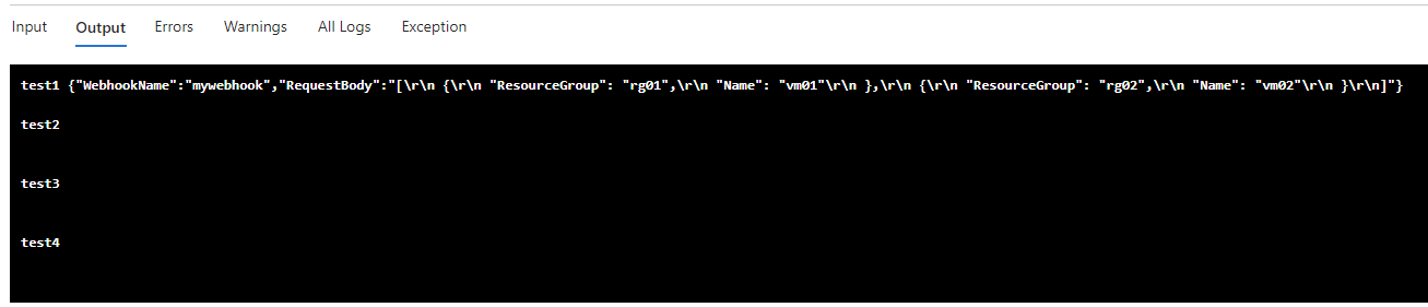

    For illustration, check below screenshots of runbook execution and output. Note that in this example RequestHeader and header1 under RequestHeader is not showing any output as the input JSON object doesn't have those related details. So, based on the use case you might have to provide input JSON object in the required format with carriage returns and newline characters, so it matches the format that is passed in from a webhook. User's image
