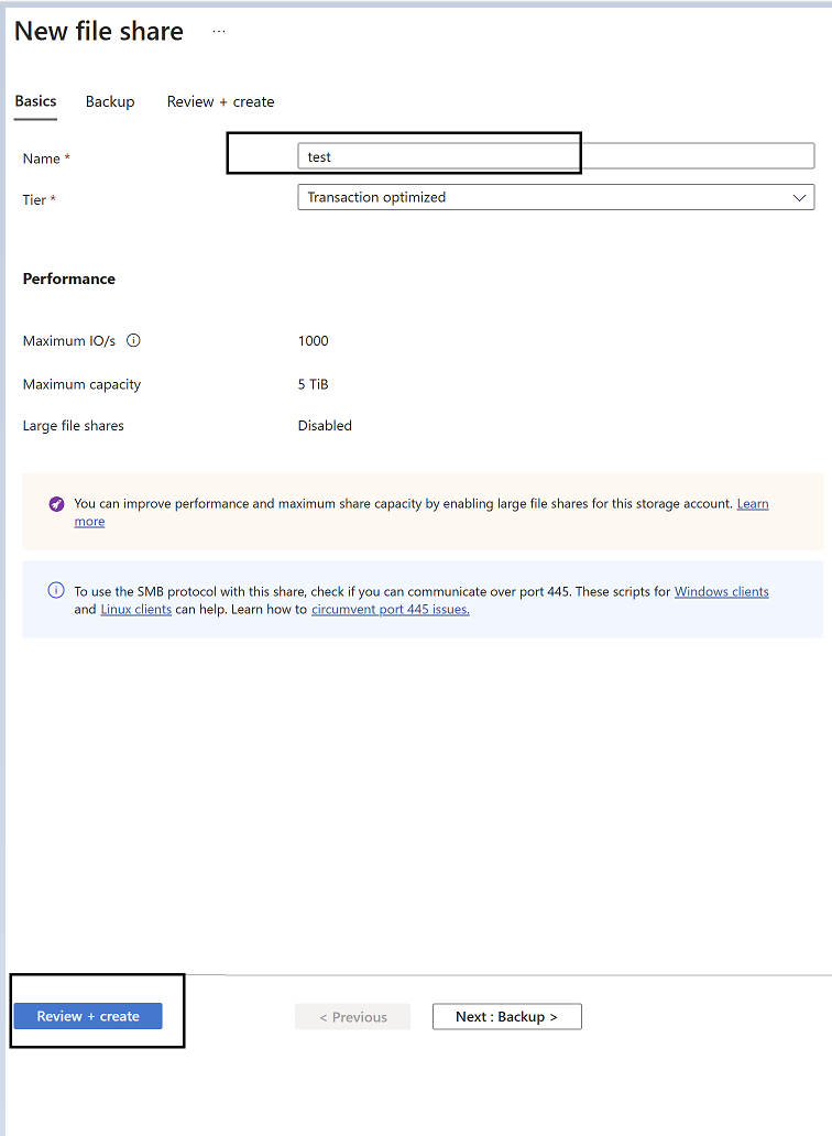

    Step:2 Create Azure File share

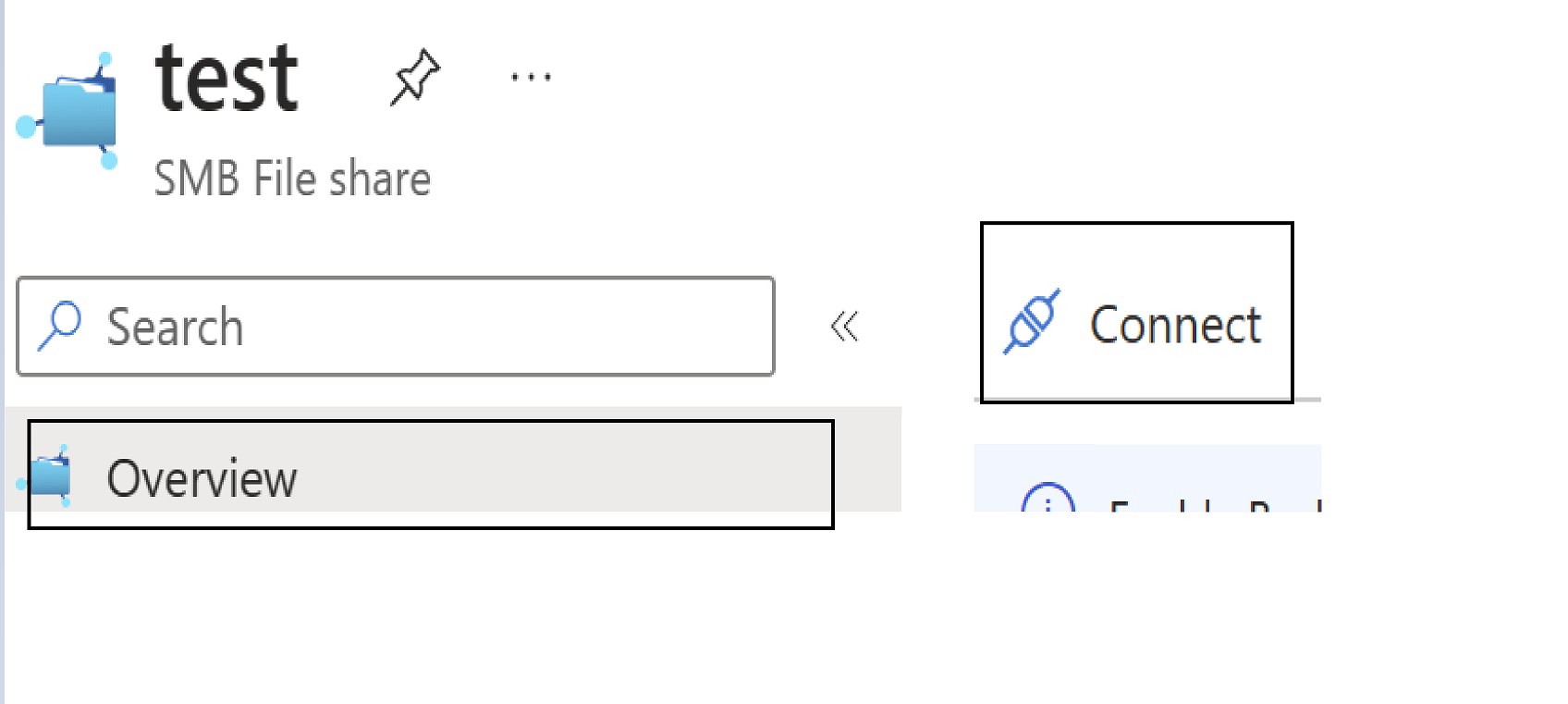

    Click on the Connect option from the newly created Azure File share.
    Copy the Script in the Notepad and note the -Root and User and pass fields to use in the below steps.

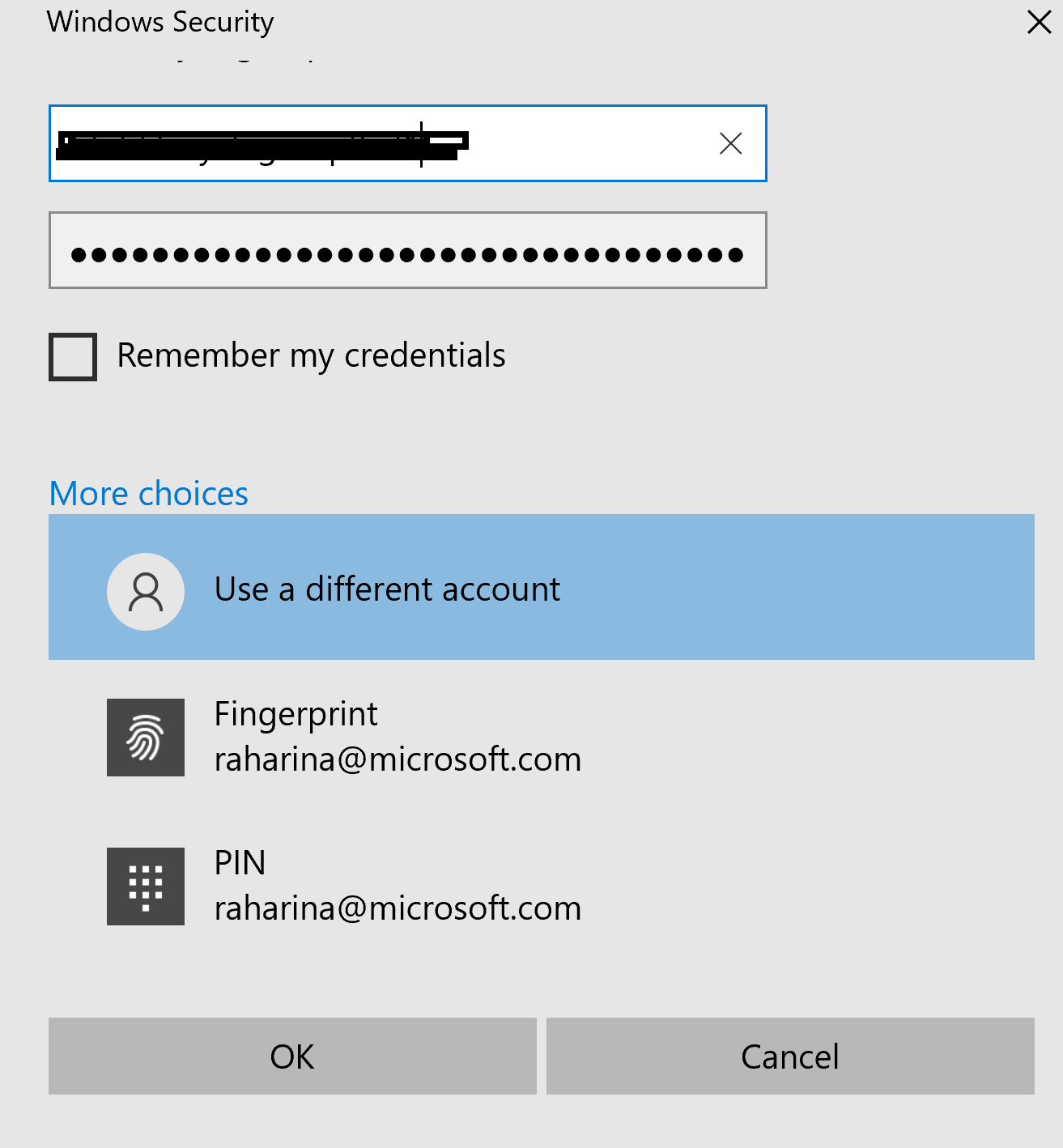

    You can directly access your Azure file share using the UNC path by entering the following into File Explorer. Be sure to replace storageaccountname with your storage account name and myfileshare with your file share name:
    \\storageaccountname.file.core.windows.net\myfileshare
    You'll be asked to sign in with your network credentials. Sign in with the Azure subscription under which you've created the storage account and file share. If you do not get prompted for credentials you can add the credentials using the following command:
    cmdkey /add:StorageAccountName.file.core.windows.net /user:localhost\StorageAccountName /pass:StorageAccountKey
