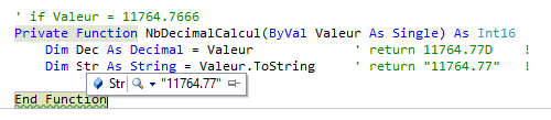

Hello,
I'm having a problem converting a single to a decimal or a string.
In the example, I'm trying to convert a single passed as a parameter into a character string (for example).
' if Valeur = 11764.7666
Private Function NbDecimalCalcul(ByVal Valeur As Single) As Int16
	Dim Dec As Decimal = Valeur             ' return 11764.77D    !
	Dim Str As String = Valeur.ToString     ' return "11764.77"   !
End Function
The conversion doesn't work correctly. The simple is rounded to 2 digits.
See screenshots
Microsoft Visual Basic 2010 Express - Convert Single to string
Microsoft Visual Basic 2010 Express - Convert Single to string02
Thx.
Steeve
Visual Basic 2010 - Express

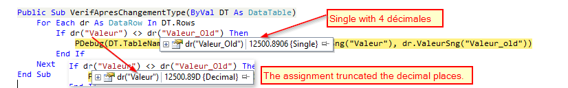

    Hi @WayneAKing and @Jiachen Li-MSFT
    Thank you for your feedback.
    So why doesn't it always work!
    Example:
    The S3 case, when assigned, trims a digit
    Microsoft Visual Basic 2010 Express - Convert Single to string03
    I must be tired!
    Best Regards.
    Steeve
