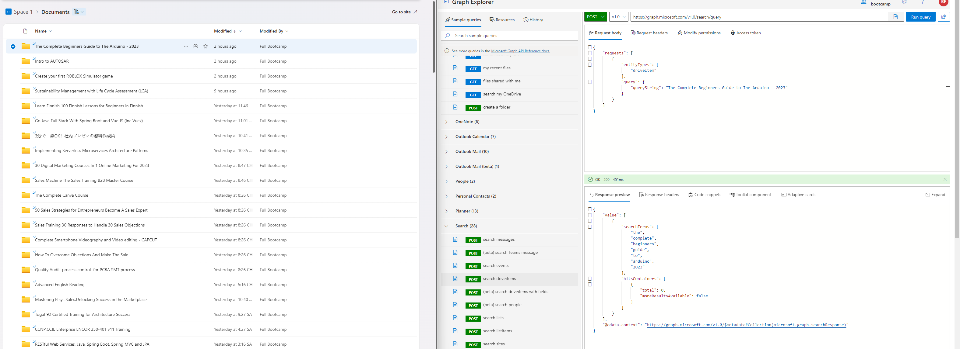

My file has been uploaded to share point and I use api to search for this file.
but doesn't return any results.
Screenshot 2023-09-15 011159

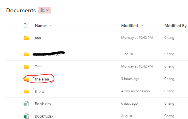

    Hi @ Bootcamp Full
    Judging from the question you provided, the cause of the problem is:
    There are spaces in the middle of your file name, and the spaces will be queried in chunks.
    Please enclose the file name "the a a" in double quotes to ensure that search engines see it as an exact matched phrase rather than a separate word. This will help you find files with exact file name matches.
    Here is a test for your reference:
    Here is test result:
