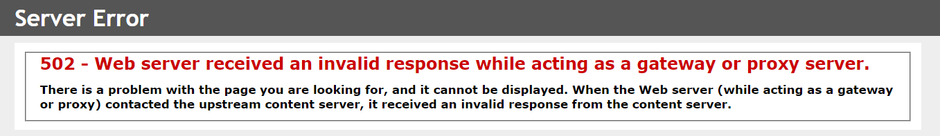

I have identified an issue within Azure App Service that results in internal server errors when working with file upload APIs. To demonstrate this issue, I created a sample .NET API.
Repo: https://github.com/sreejith-ms/WeatherForecast-AppServiceIssue
API: POST /WeatherForecast/maxsizelimit
This is a multipart file upload API that has a maximum request size limit of 2MB.
When I attempted to upload files ranging in size from over 2MB to approximately 14MB, the API responded correctly with a 400 Bad Request error, indicating that the request body was too large. However, when attempting to upload files larger than 14MB, the App Service started responding with internal server errors (500/502). The size of 14MB is where I mostly encounter the issue; however, the size may vary based on your network bandwidth.
Interestingly, the App Service logs clearly indicate that the container responded with a 400 bad request error.

It's worth noting that the issue does not seem to be related to the file size (14MB) because the same file uploads successfully using another API that does not have any request size limits, relying on the default Kestrel limit (around 30MB).
If you attempt to upload files larger than 30MB, you will encounter the same internal server error.
To confirm that this is indeed an issue with the Azure App Service, I deployed the same application to Azure Container Apps and the upload APIs worked as expected without any issues.

P.S.: The issue may not be reproducible when testing from a high network bandwidth connection. In such cases, you can try using browser network throttling. I used Firefox throttling preset: WIFI (download: 30 Mbps, upload: 15 Mbps)
