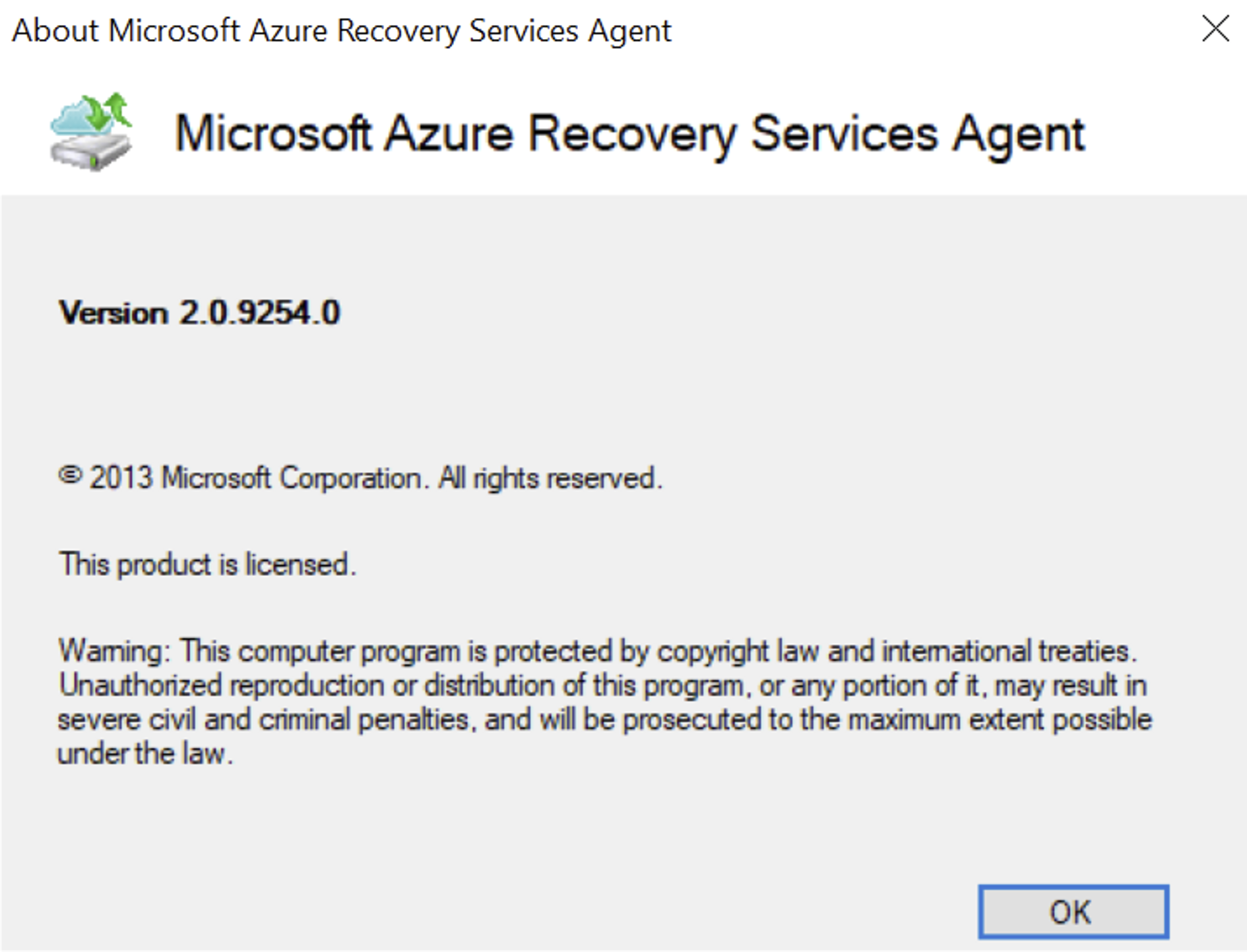

I setup MARS on several of our servers. But one server now stopped backing up with a general error.
I find these in the CBEngineCurr.errlog
