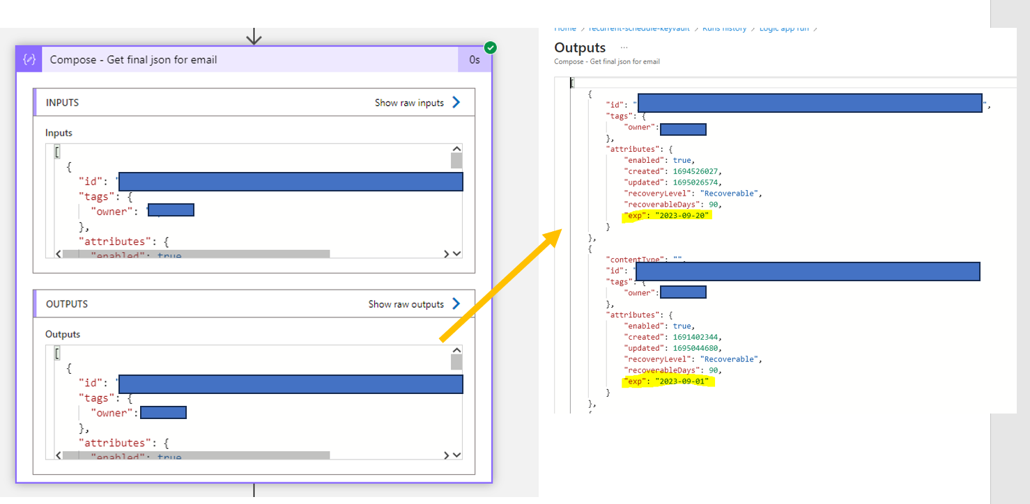

Hello,
I need to sort this json by the "exp" key, ascending. How can I do this? Standard sort() function does not do the jobUser's image

    @Anonymous Thanks for reaching out. Sort method would have helped in scenario when your property is not the nested JSON object.
    For example, if your json would be below and you want to sort it with the property ex then you would have used the
    sort(body('Parse_JSON'),'exp') but this doesn't work with the nested json object properties.

    The workaround would be leveraging the liquid template or use the inline code to sort it as per your need.
