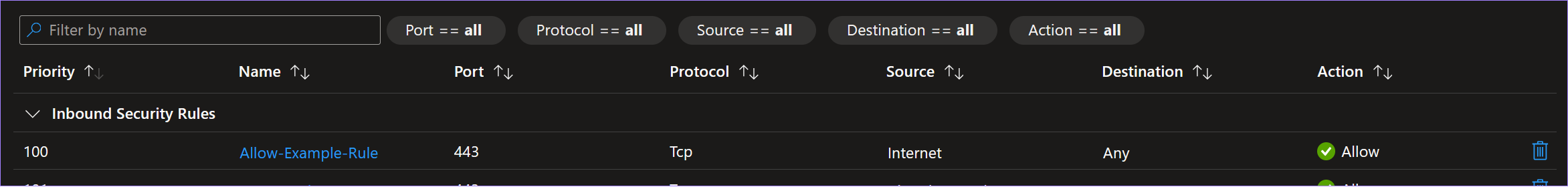

    I was able to execute the script successfully at my end and add the Allow-Example-Rule as shown below.
    Hope this helps! Please let me know if you have any additional questions. Thank you!

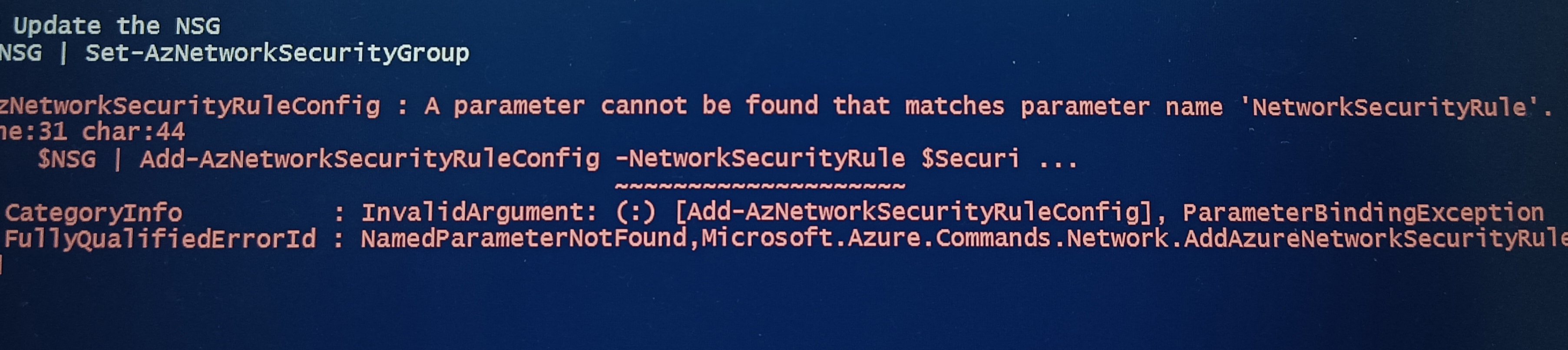

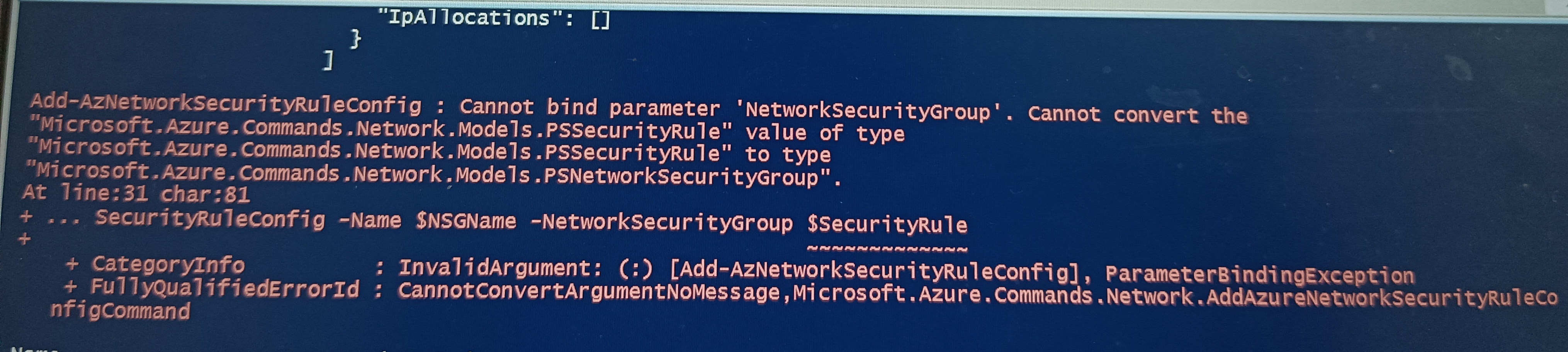

  2. msrini-MSFT 9,291 Reputation points Microsoft Employee
    2023-09-19T03:00:33.3433333+00:00
    I tried to fix the error in the above mentioned PS script:

        $NSG | Add-AzNetworkSecurityRuleConfig -Name $NSGName -NetworkSecurityGroup $SecurityRule
        # Update the NSG
       Set-AzNetworkSecurityGroup -NetworkSecurityGroup $NSG
