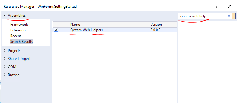

    • Update1:
    System.Web.Helpers.XXXX is included in this reference: System.Web.Helpers, please also remember to add System.Web.Helpers reference by right-clicking References > Add Reference… > Assemblies > type system.web.help in the “Search box” and select the System.Web.Helpers reference > OK.

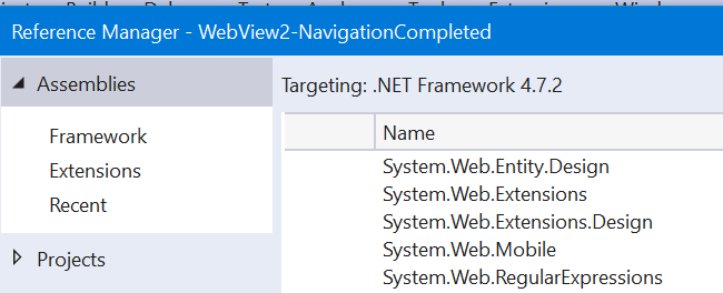

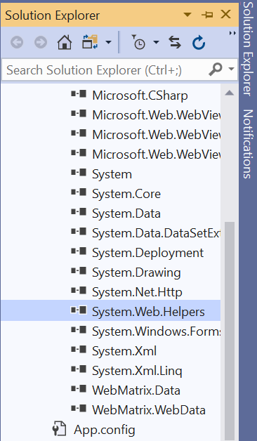

  4. vmars316 621 Reputation points
    2020-11-07T00:55:28.51+00:00
    Sorry to say , I tried all that you mentioned :
    These are the error msgs when trying to compile with 'PF5' ,
    Because there is no Start Button .

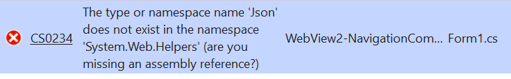

    Severity Code Description Project File Line Suppression State
    Error CS0234 The type or namespace name 'Json' does not exist in the namespace 'System.Web.Helpers' (are you missing an assembly reference?) WebView2-NavigationCompleted C:\Users\vmars\source\repos\WebView2-NavigationCompleted\Form1.cs 24 Active
